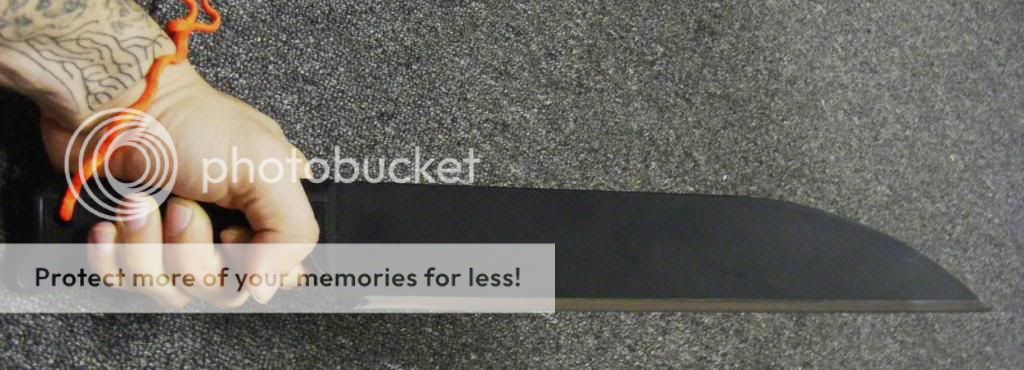

Today's review is a Cold Steel machete. This is one of the machetes from the new line, and is made in China (as opposed to the older ones, made in South Africa). This is the 12" Sax Machete, model CS97SA125. It's also available with an 18" blade, and is a re-design of the traditional Scramasax (which it resembles a little bit). In-store price is around $11, and it incudes a sheath (unlike the South African-made models). This model weighs just over one pound (16.3 ounces).

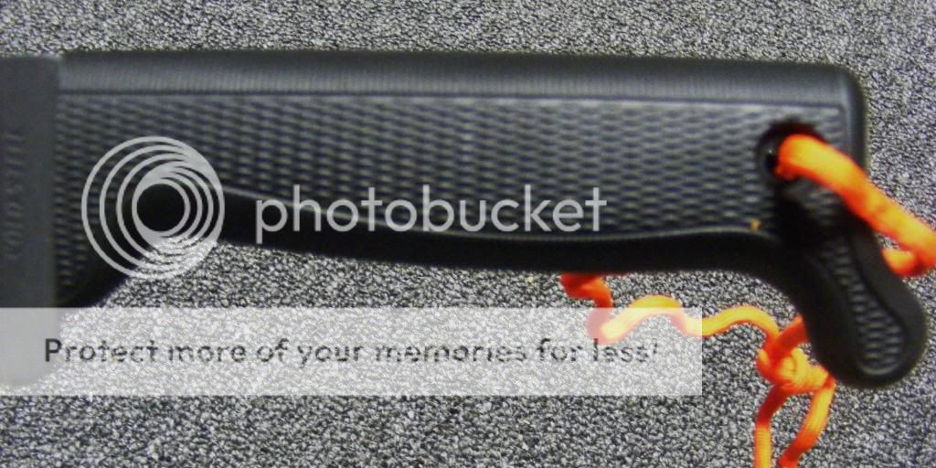

The Handle: The Sax' handle is made of black polypropylene (hard plastic). It's 5-5/8" long from the very end of the handle to the blade's start. The handle is 7/8" thick, and there's 4-1/4" of usable space between the guard and the little retention butt. This is enough for me, and my hands are pretty big. The texturing is checkered on the sides.
The front and back of the handle is textured with simple lines...
The lanyard hole is large enough for non-gutted 550 cord, which I recommend so you don't lose your tool if you lay it down in the woods.

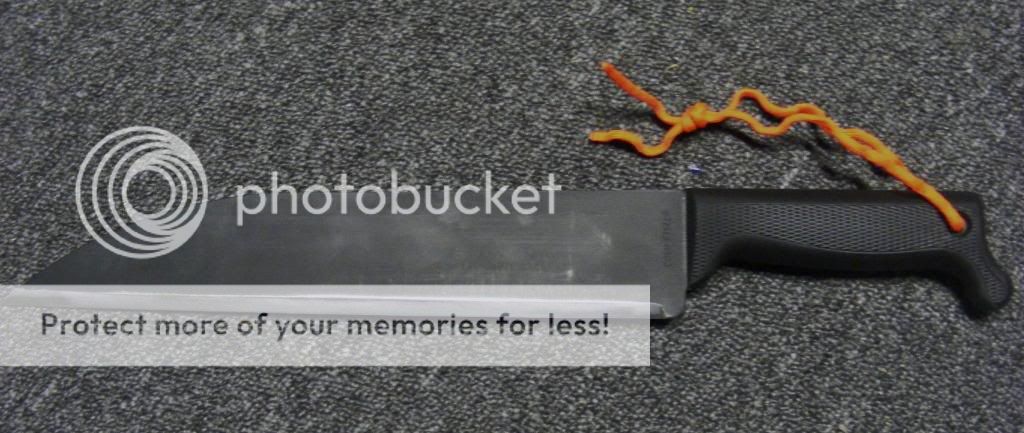

The machete is a bit blade-heavy, as the balance point is about 1/4 of the way up the blade. I'm not sure if this is a full-tang design, but it has held up nicely for me. In-hand, it fits me very nicely.
The Blade: The Sax' blade is made of 1055 carbon steel with a Rockwell hardness of about 54-56. It measures 12" long with an 11-3/4" edge. It's just a hair under 1/8" thick. The blade is covered with a baked-on anti-rust finish, which is black. This finish covers the edge as well, which came pretty dull. The machete had a usable edge for the woods, but would really benefit from a bastard file or a belt sander for a really nice edge.

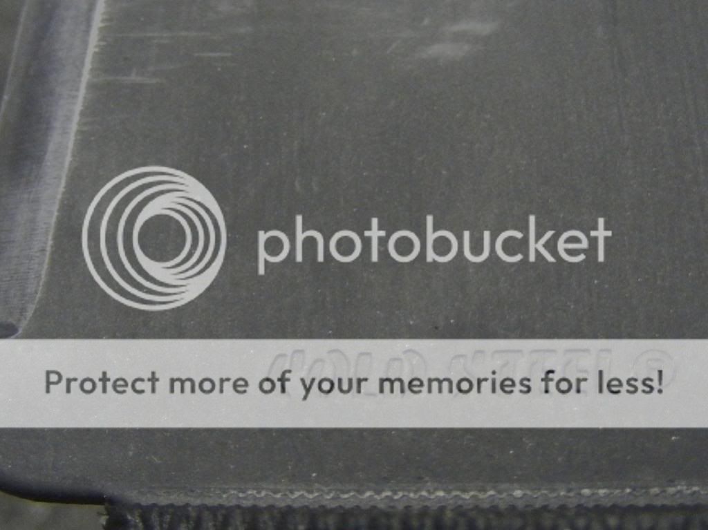

The left side of the blade tang is stamped as follows:
And the right side tang...

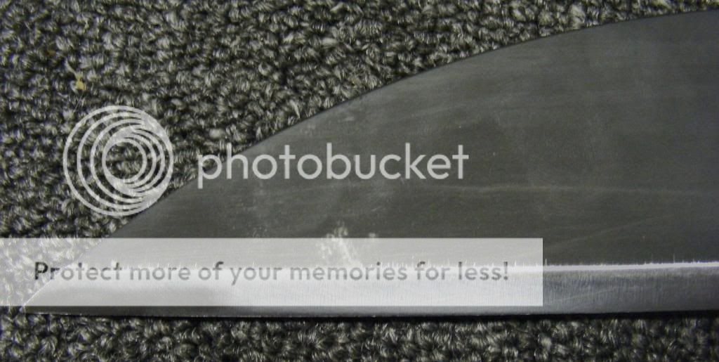

After a rough grind on a belt sander, then a ceramic stick, the edge really came to life. The blade is best described as a modified wharncliffe, and the point really lends itself to piercing.
This is a cardboard mailing tube (1/8" thick) that I let the Sax machete fall into by its own weight from 12"; no stabbing. It penetrated just over 1/2".
I rather like this blade shape for general use, and as a machete, it's still pretty good. I'd like to have more steel toward the tip of the blade to help out in chopping, but the Sax machete still performs very well.

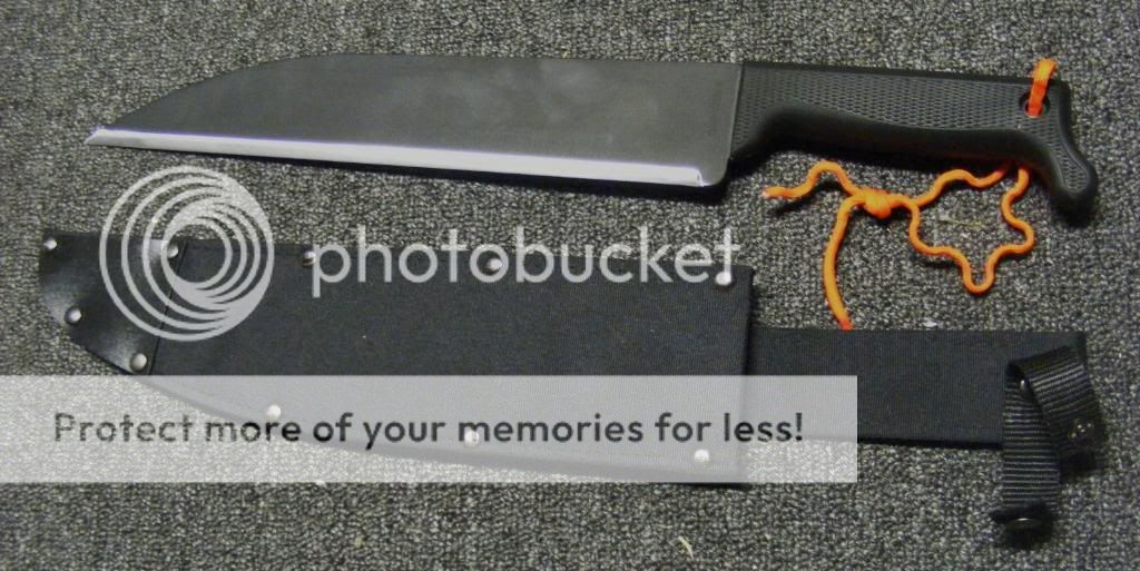

The Sheath: The Sax machete comes with a simple black nylon sheath. It's 17-1/2" long overall, and 18" long with the machete inserted. It's heavily-stitched and there are steel rivets along the sides, as well as a plastic safety toe at the bottom. The handle can be secured with the snap closure, but I've found it to be unnecessary when attached to a belt in the woods.
The belt loop is sewn to the back, and will accomodate a belt up to 3-1/2" wide belt.
For me, this wide loop hasn't caused any migration problems. The button snap is held on with a single rivet, and can be rotated for a different placement of the snap. The sheath isn't designed for this, but it can be done, so don't do it too often or you'll wear the material down.

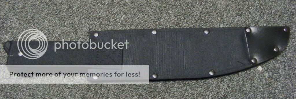

The back of the sheath, showing the belt loop...
Overall, the sheath is okay. It's not one of those lightweight flea-market deals for sure and it gets the job done. The machete can be inserted in the sheath one way only (the way shown in the first photo of this post).

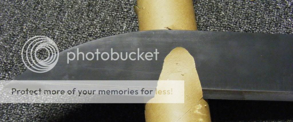

This cut was made with just the weight of the machete from a height of 12". Material is a 1/8" thick cardboard mailing tube. The blade went in about 1-1/2" down (from a 2-1/8" wide blade) and bit 1/4" deep.
I like the Sax Machete. To me, the 12" blade length makes it a lightweight, yet heavy-duty chopper for the woods. The Cold Steel machetes are made a little thicker than traditional machetes, and won't flex as much. I like this for more dense vegetation as well as soft woods. For lighter-weight vines and weeds and such, I'd say to stick with a traditinal style (Tramontina, Ontario, etc.) machete. Try one out and see how you like it.
