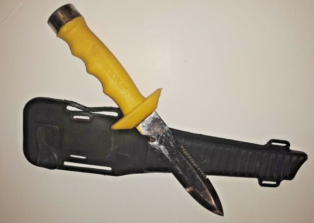

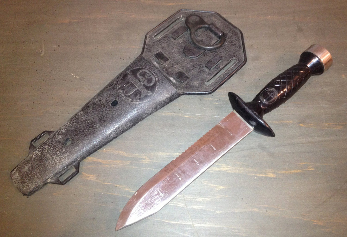

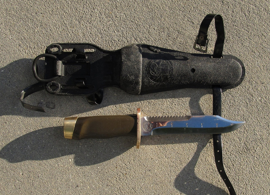

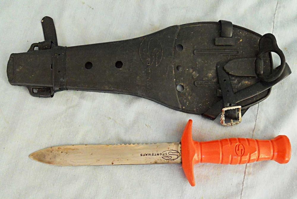

As a former scuba diver of many years I've seen alot of dive knives big and small. With just a few exceptions going back to the 50s/60s, dive knives generally follow two patterns; one is that they have at least some serration, sometimes an entire edge-because nothing cuts wet rope underwater as well as a serrated blade. And two, they do not have metal bolsters for the obvious reason that it's just another piece of steel prone to rust. I can add that they do often have pommels though, because sometimes when you need to get your dive buddy's attention you can tap your tank behind you. Dive knives are universally straight bladed as they are often used as tools for prying underwater. In fact because of this, some makers eventually disposed of the pointed tip entirely. The steel type has never needed to be based on edge retention, but rather corrosion resistance. And for this reason steels such as Aus6, 420j2 and Krupp 4116 variants are commonly used. Today there is at least one Titanium one which developed from the military need for a non-magnetic one. Bear in mind that "dive knives" are different from "spearfishing knives", the latter being more like daggers for quick kills. So, a CS Tanto "can" certaibly be used as a dive knife (as just about any knife can) but it was never designed for it.
Deaf_Smith is not the first person to mention using a Cold Steel Tanto as a diving knife on these pages. It was brought up once in one of my older threads, as well. But, like Ken, I'm always rather shocked by the choice to use the Tanto that way. I'm not a diver myself, but I recognize what divers need in a knife. I also know about knives and what sea water does to them.

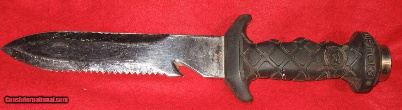

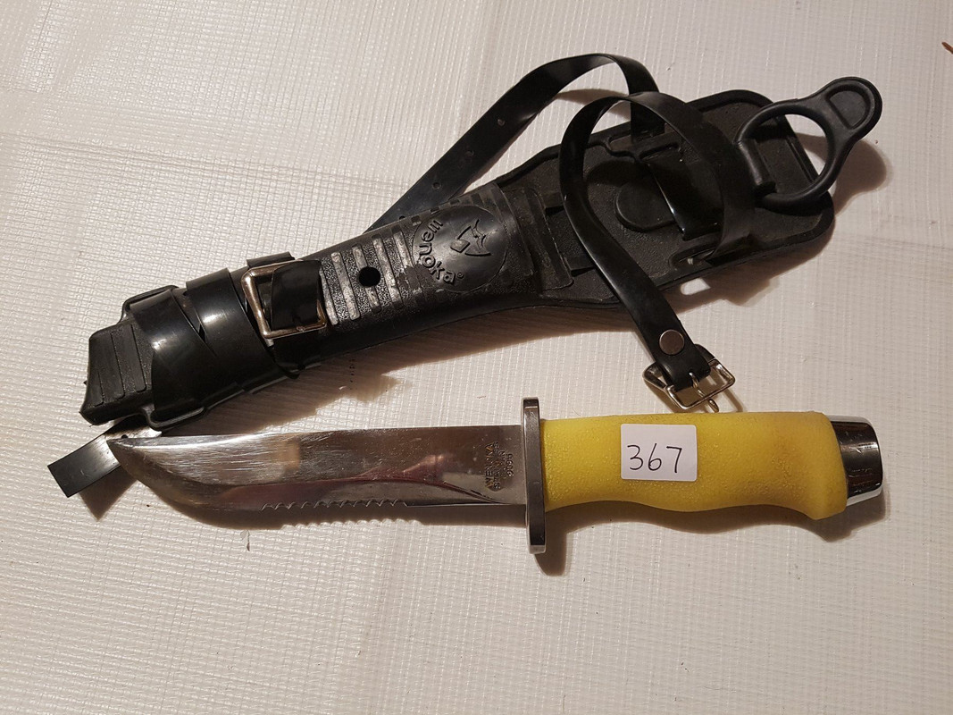

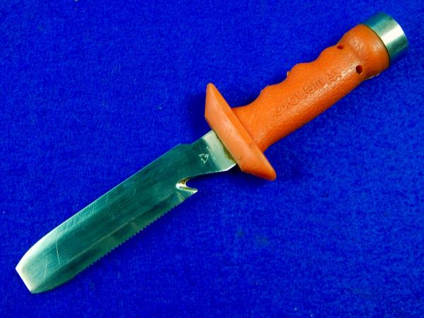

To all the points that Ken raised about his surprise at someone diving with a Tanto, I'll add this. When Cold Steel's Tanto was taking the knife world by storm in the early 1980s, there were already multiple companies making dedicated dive knives. By far, the biggest were Wenoka
and U.S. Divers.
But Tekna
and a lot of other companies offered dive models, as well.

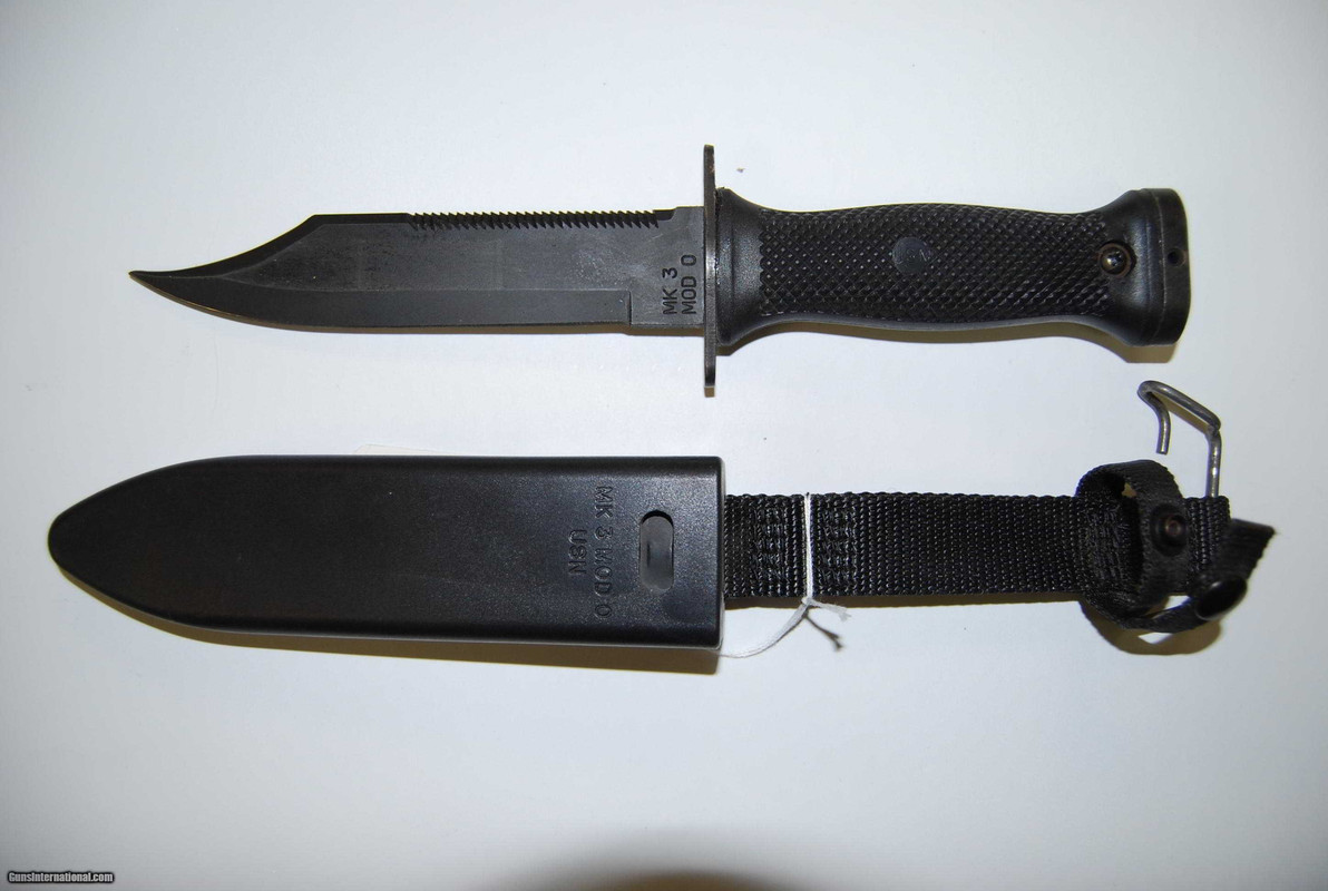

Even the Ontario MK 3 was supplied by the military as a dive knife at that time.
In addition to being designed by divers (or at least with diver input) and made for diving applications, all of these knives were significantly less expensive than a Cold Steel Tanto. The Tanto has only ever been marketed as a fighting knife. Yet I marvel at the other roles to which owners have applied it.
