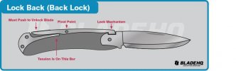

Over the Labor-day weekend Blade Head-Quarters had a lot of different knives on sale, and one "inexpensive" one that caught my eye was one of the Blue Pro Lite sport knives for $21.99 it was a "cannot resist the temptation", and I've been sitting here with it trying to figuire out what makes this "Triad lock" so special from a hundred different lock backs I've handled over the years.. Yes, it's smooth both on opening and closing releases cleanly, but it seems to be a fancy new name for the generic "lockback"
What am I missing.

Main difference is that the Tri-Ad lock has a stop pin between the blade and lockbar to redistribute force. It's also designed to self-adjust as it wears.

Adding one stop pin changes all lock and applying force vectors. Pushing on the cutting edge (cutting/chopping) - load comes on the stop pin, not the lockbar and its pivot. Whacking with blade spine - main strain comes on the locking tooth, compressed between blade cutout and stop pin.
Wery sturdy construction, as a bonus - small reserve for wear off.
