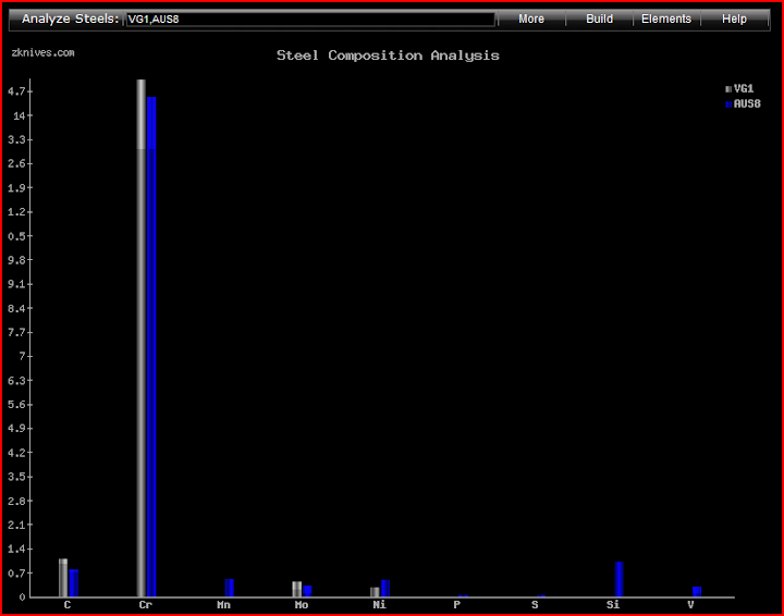

VG-1 absolutely IS high-carbon, and it's quite different from AUS8A.
As for heat treat, I have no facts to back up my personal experience, which is that VG-1 will chip at times, but I've never had an SM3 blade chip on me.
