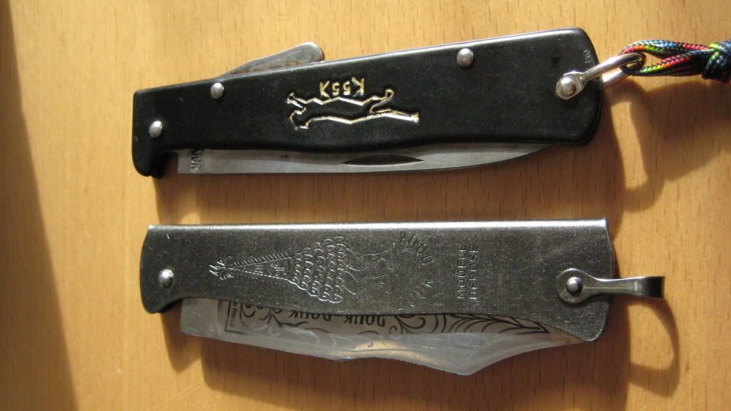

Here are some pics. The K55K is the knife with the little lanyard ;)
As you can see here, the DoukDouk is slightly longer than the K55K when it´s opened
The DoukDouk has a very unique bladeshape - but for me it´s a clippoint - the K55K seems to have a very narrow spearblade

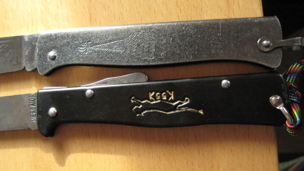

The handles are a little the same - the K55K is painted in black with added cat and written K55K (Kaufmann, 55th Street, Köln - Cologne) and the DoukDouk shows a mystic creature (shamane) on the handle, but thats punched or better engraved and the handle. About the handle of the DoukDouk, I have no idea. It´s not painted - but gives the handle a silverish appearence.

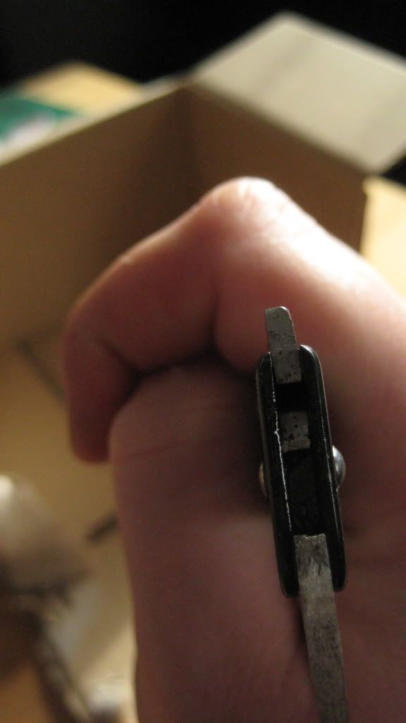

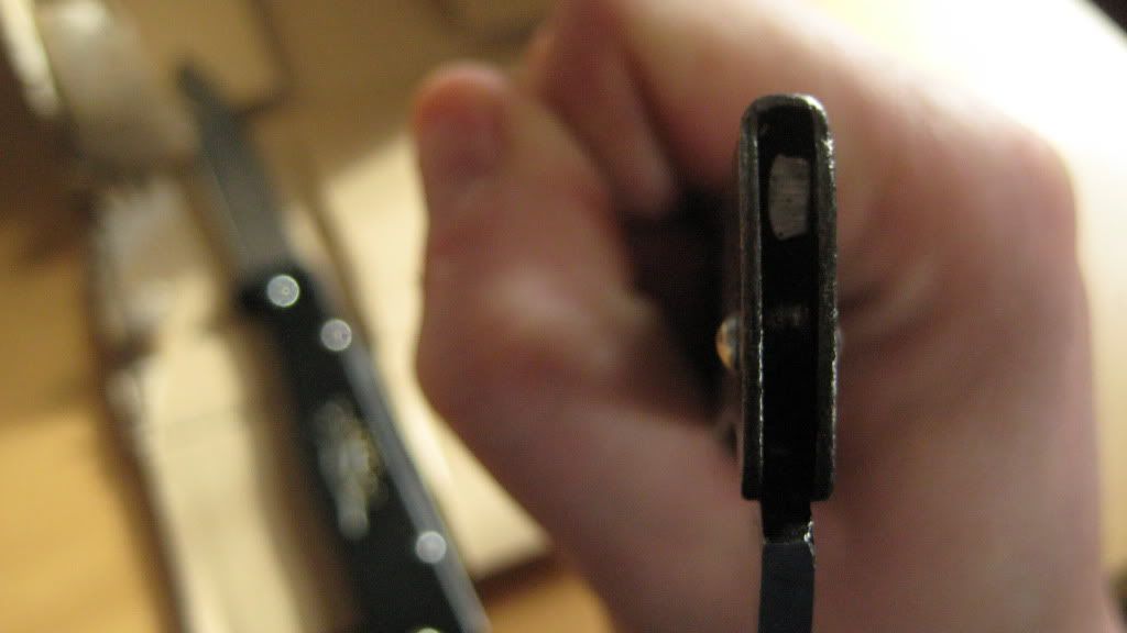

This gives an appearence of the handle. The K55K is straight and the DoukDouk makes a little convex at the handle, so it fits better in the hand than the K55K. Especially when working with it a longer time. But the handle on the K55K seem to be a little thicker than the DoukDouk.

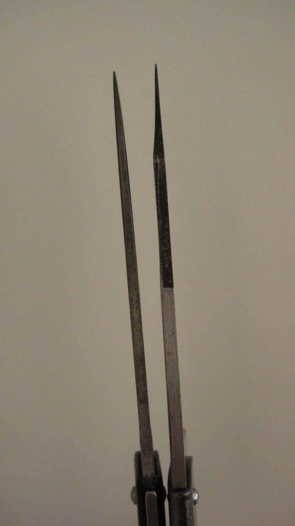

The blade thickness on both is nearly the same, again ;) - but the DoukDouk seems to be a little thicker than the K55K. Here´s another little difference, the DoukDouk has really a needle-like tip. The K55K is not that needle-like. It´s more a coarse tip.

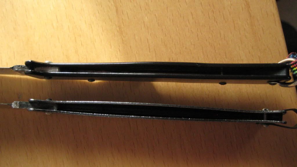

This shows the backspring of the DoukDouk. It´s a real slipjoint. And you can believe me, it´s like a tank. It has a halfstop built in. Until the halfstop the knife opens nicely, with a pull roundabout a 6 (of 10 highest). After the halfstop - it´s hardly to open as well as to close, so there´s an 8 (of 10 highest). Once the blade opened, the DoukDouk stays in that place. No danger of closing accidently.
This shows the locking mechanism of the K55K. It´s a traditional lockback, but the lockbar is at 1/3 in front at the blade. When it´s opened, it´s hard to press the lockbar and close the knife accidently. So we have another tank here ;) . But the pull is very light and smooth, so there´s a 4-5 (of 10 highest). And the knife can be opened with one hand, after some practising.

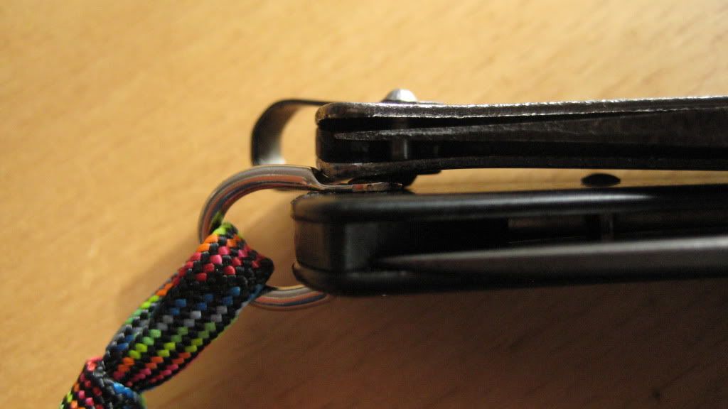

The knives closed and be together.
As you can see here, the blade of the K55K is not centered after all. The DoukDouk is. But that pic is not representative - I used the K55K for real hard work on the building lot and while firewoodmaking in the wood and around the house. The DoukDouk is just a few days in use.
But you can see the F&F compared to each other. The DoukDouk is more coarse finished. The "paint" is not everywhere on the handle, while the K55K is well painted to protection of rust.

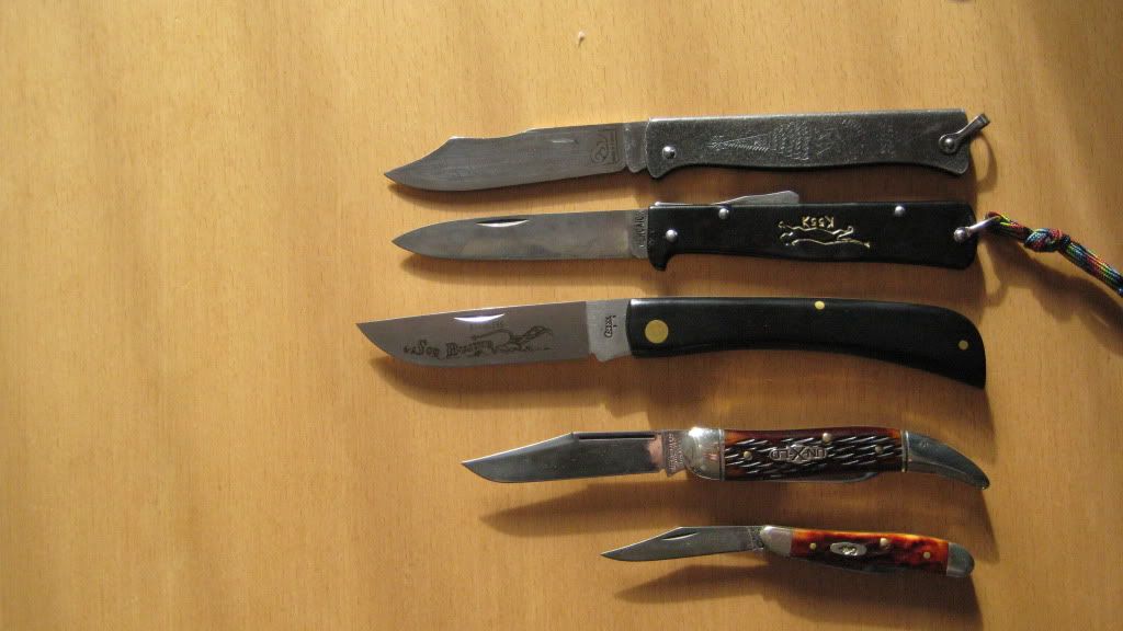

Size comparison to other knives I had around and ready to grab them.
