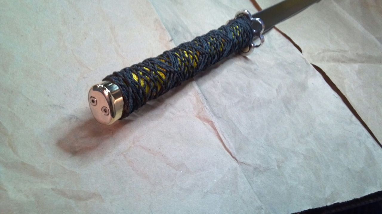

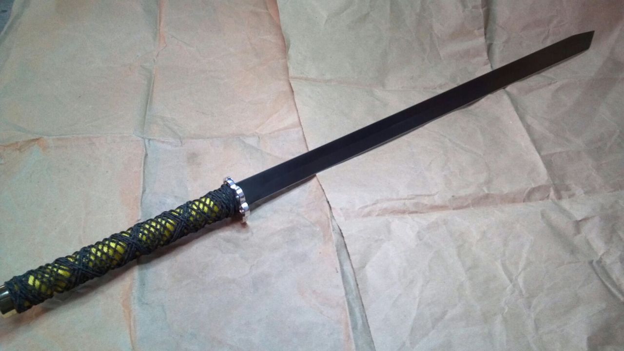

This sword is made with a length of bi-metal band saw blade in between two pieces of carbon fiber, with the spine being 3 pieces of carbon fiber thick with each of the carbon layers being .055" thick and epoxied together with 8115 3M epoxy. This time around, the sword has a wider blade, 1 3/16" wide, and increased strength . The hand guard is made of magnesium and brass, as is the end cap on the handle. The handle is titanium tube sliced in half and wrapped with paracord. The blade comes in at 28", 36 3/4" overall.

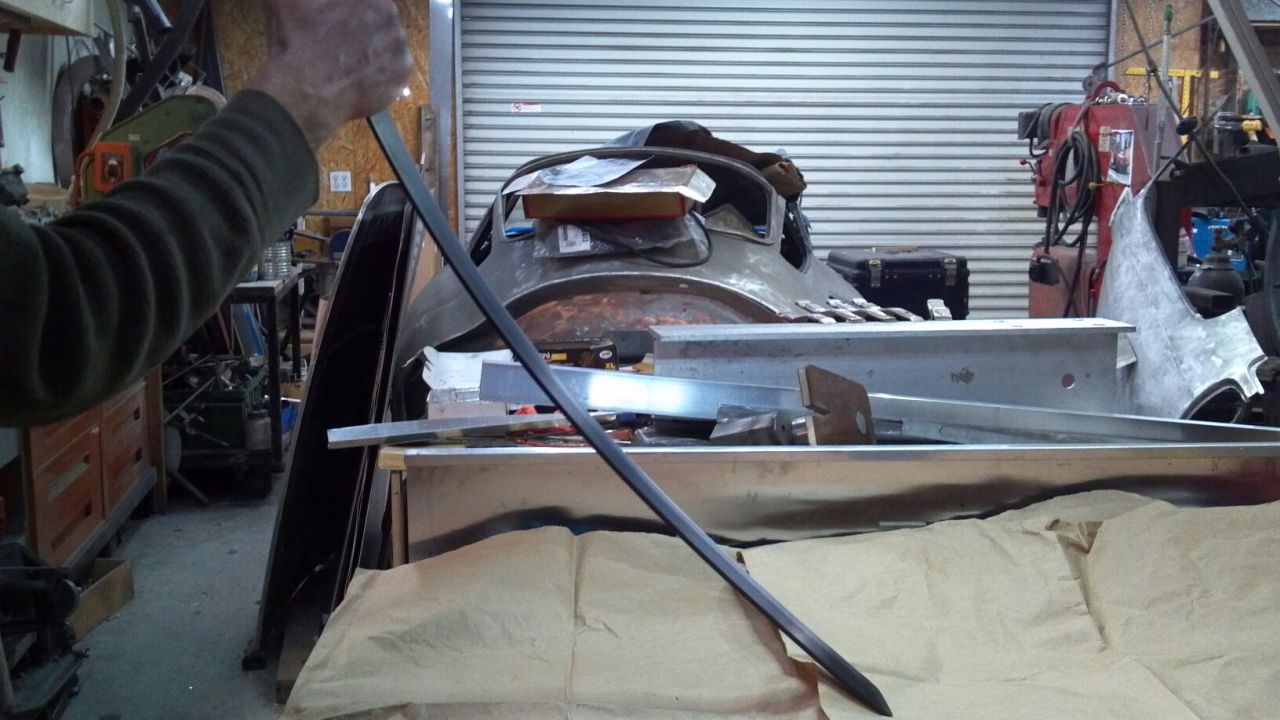

We also tried to bend the blade as far back as we could, but it is incredibly strong. This is how far we could bend it with just our hands. The blade does not stay bend and easily returns to being straight.
