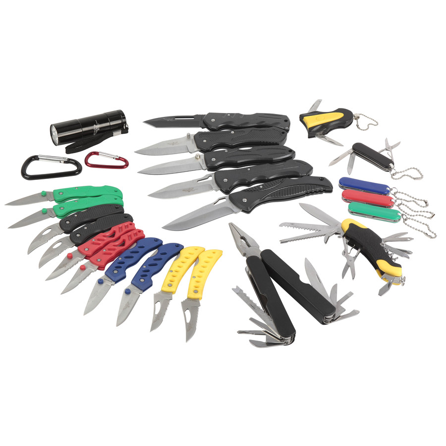

I was in Lowe's today and saw this set which is down to under $20:
I considered picking up a set to practice sharpening, but then passed since I am sure it is pretty crappy steel. However, it does have a decent variety of blade sizes and shapes, which could offer plenty of practice holding angles while freehand sharpening. For that I may have to go back and pick up a set.
http://www.lowes.com/pd_503066-50034-51551_0__?productId=50086744&Ntt=appalachian+knived&pl=1&currentURL=%3FNtt%3Dappalachian%2Bknived&facetInfo=
