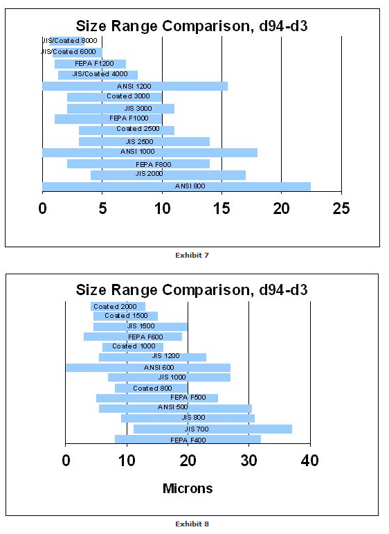

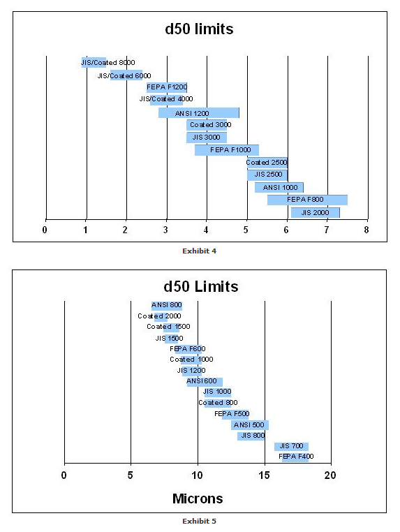

Within a single mesh size, there are smaller and larger particles. The mesh size is basically the median size of particles _by weight_. (I'm throwing away some details here.) Beyond that, the actual distribution of particle sizes has very little restrictions, according to most official engineering standards.
What we're really interested in is the distribution of scratch sizes produced by an abrasive (is the distribution very uniform, very non-uniform, with a single peak, with multiple peaks?). This turns out to be very complicated too. Here is just a brief partial list of things that affect scratch size:
1. Particle size
2. Particle hardness
3. Particle friability (how easily it breaks into smaller particles)
4. Particle shape (round and smooth, blocky, or thin and splintery?)
5. Bonding medium (vitrified, sandpaper, loose, leather, etc.)
6. Aggregation (whether or not small particles (say in solution or paste) tend to clump together and basically form a "big" particle).
7. The properties of the materical you are abrading away (cast iron, carbon steel, stainless steel, ceramic,...)
As a result, it becomes very hard to compare one grit size with another if you change manufacturers, and/or abrasive materials (diamond, SiC, AlO). Sadly, the official engineering stanards are very loose and unrestricted (JIS, FEPA, ANSI).
If you're curious about some of the technical details for how abrasives are graded in manufacturing, you can read part of this thread (I made a few posts about what I found, but I'm no expert!):
http://www.knifeforums.com/forums/showtopic.php?tid/904090/tp/6/
In particular, have a look at this overview of the offical engineering standards (FEPA, JIS, ANSI). This is from the United Abrasives Manufacturer's Association (UAMA):
http://www.uama.org/Abrasives101/101Standards.html
Komitadjie has done a great job with the Grand Unified Grit Chart, but it's really just a very rough road map. You'll have to do some experimentation by yourself to see what works for you, when you switch from one abrasive type/manufacturer to another. If you do, please make a post about it too. :)
