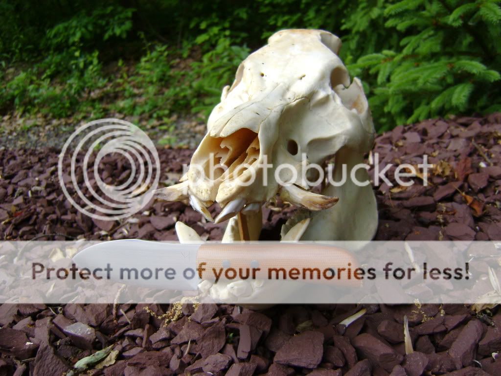

Been too quiet here...couldn't think of anything intelligent to say...figured I'd post a pic!
Did a comparison with some other small blades on the Scrap Yard...the EDC and my Weiner Dog are my best blades I've bought in a long while. They are great with wood, meat and food and as a smaller blade with a larger camp knife- you are all set!
I should have more photos up later this week. I've got a black burlap one I'm working on, and a flat grind blade version that has been ordered that I'm hand rubbing right now.

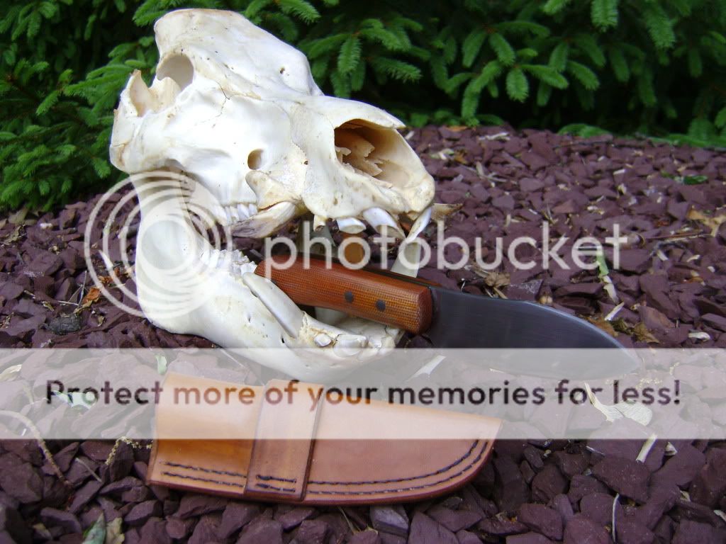

I should have the next 2 specific orders and enough blades for a couple kits int he next 2 weeks. right now, I have this variation that I finished for an order:
8 3/8 inches, blade just a hair shy of 4 inches. 15N20 steel in 1/8, with a flat grind bevel, and a V edge done with my apex sharpener (on request)- left a few forge marks on the top flats, but the overall finish is at a hand rubbed 600 grit, and hand buffed.
