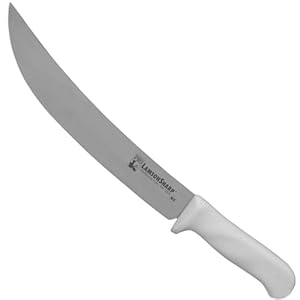

I'm unfortunately am a professional chef as the trade pays my bills and for school. i have been in the business for 8 years and full flat grind is the only way to go for a "chef knife". a 8-12" chef knife that is. also called a french knife here: http://www.kitchenaria.com/images/uploads/GEE_Cooks_Knife_10.jpg
i use a chef knife for carving meat, filleting a fish, or peeling a apple. its the only knife i need, but a "scimitar knife" is used for carving sometimes. i don't understand why as it never seems to do as nice of a job in my experience. but anyways heres a pic, these have convex edges on them
