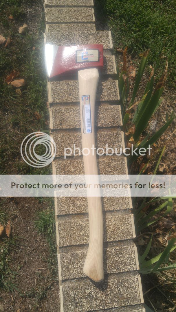

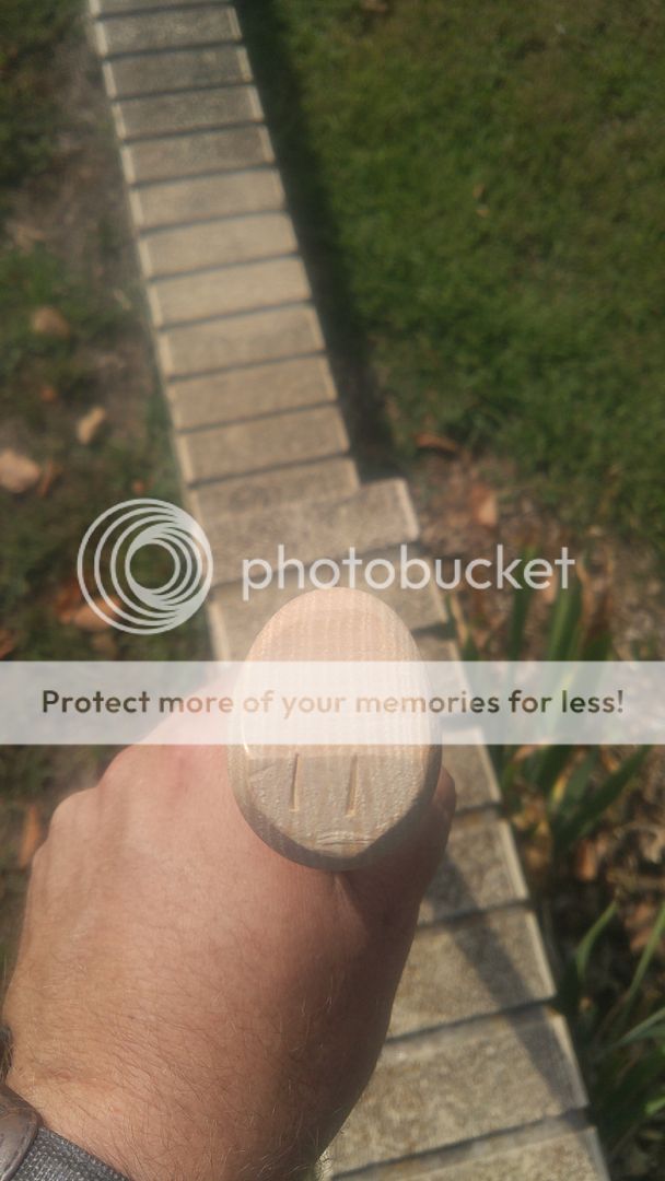

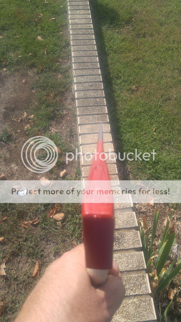

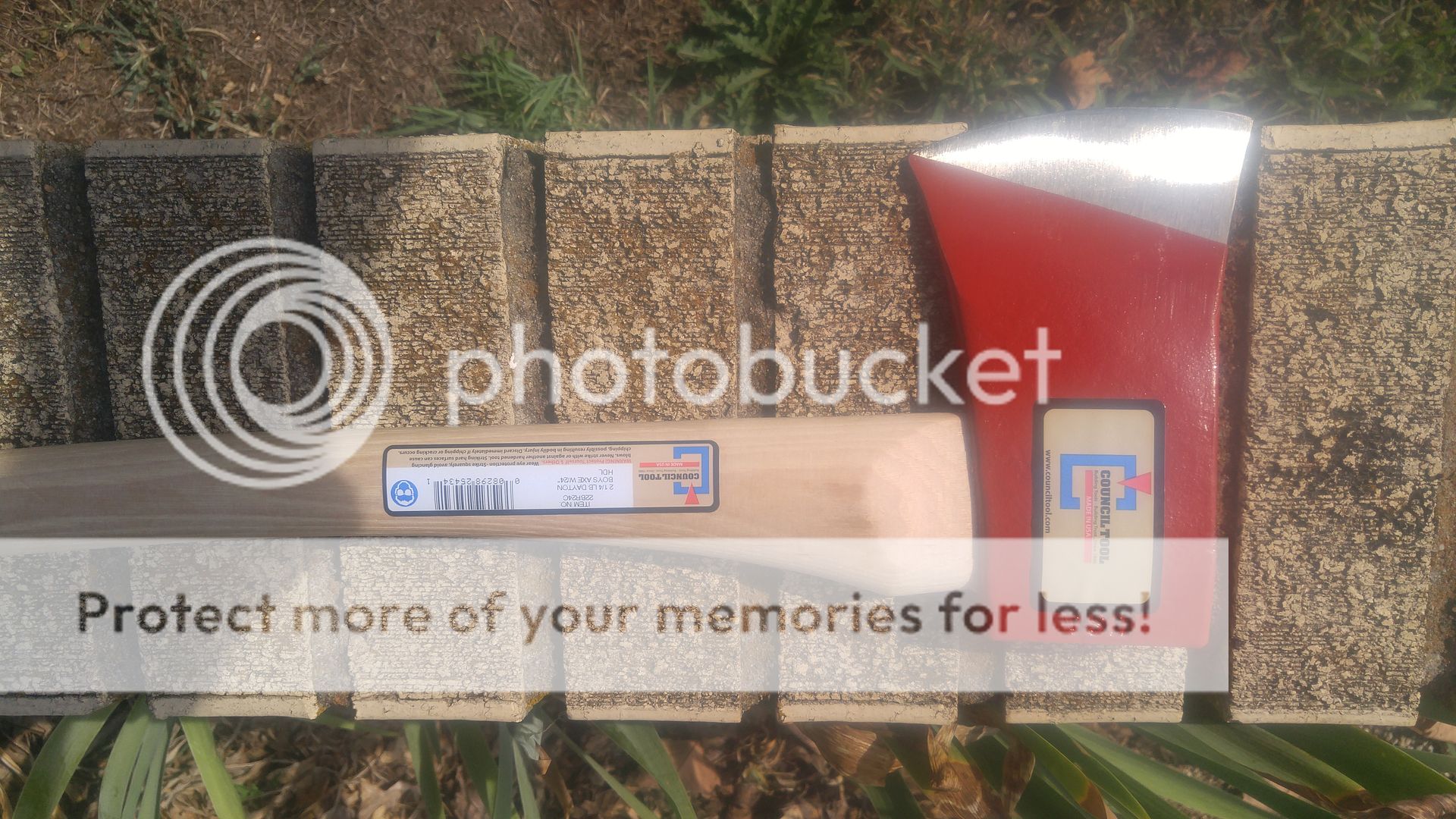

It arrived today and I'm very impressed. Amazing little axe for just under $30. Poll is very nice and flat and grain is perfect on handle. It should be a great little pack axe. Handle feels great and edge is ready to be sharpened[/URL[URL=http://s330.photobucket.com/user/dongotto/media/0829161609_zpspeckz7jt.jpg.html][/URL[URL=http://s330.photobucket.com/user/dongotto/media/0829161608a_zpsmsfydyc6.jpg.html][/URL[URL=http://s330.photobucket.com/user/dongotto/media/0829161608_zpsyng3fksx.jpg.html]
I had the regular 28ish length boys axe and it was very nice for the price. Gave it to an aspiring young axeman (with parents permission). Yours looks as good or better.
