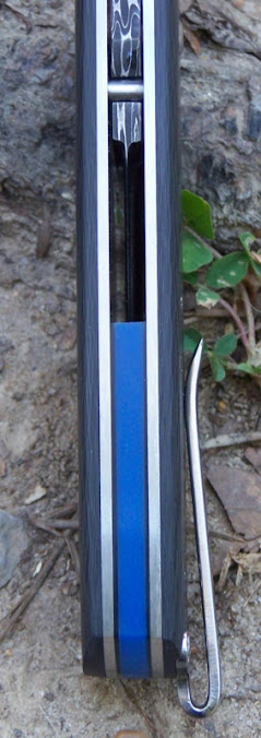

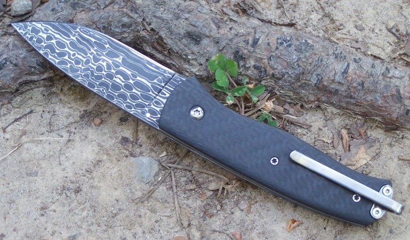

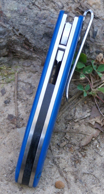

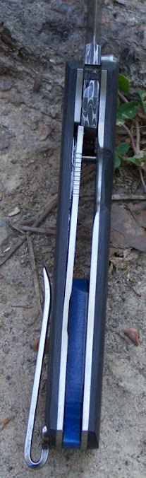

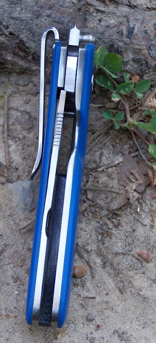

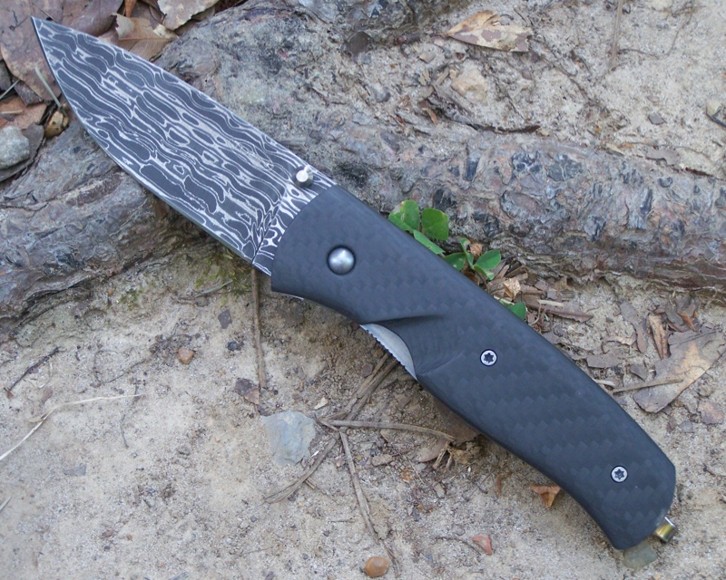

Here are a couple more liner locks I've just completed...
Both are about 4" closed and 7" opened. The blue has a blade of S35VN around .14" thick with .090" titanium liners and the carbon fiber has a damascus blade about .14" thick with .063" titanium liners. Both have my new logo as well.
Thanks for looking.

That carbon fiber and Damascus one is too legit. Really dig the low ride clip too. Great work! :thumbup:
