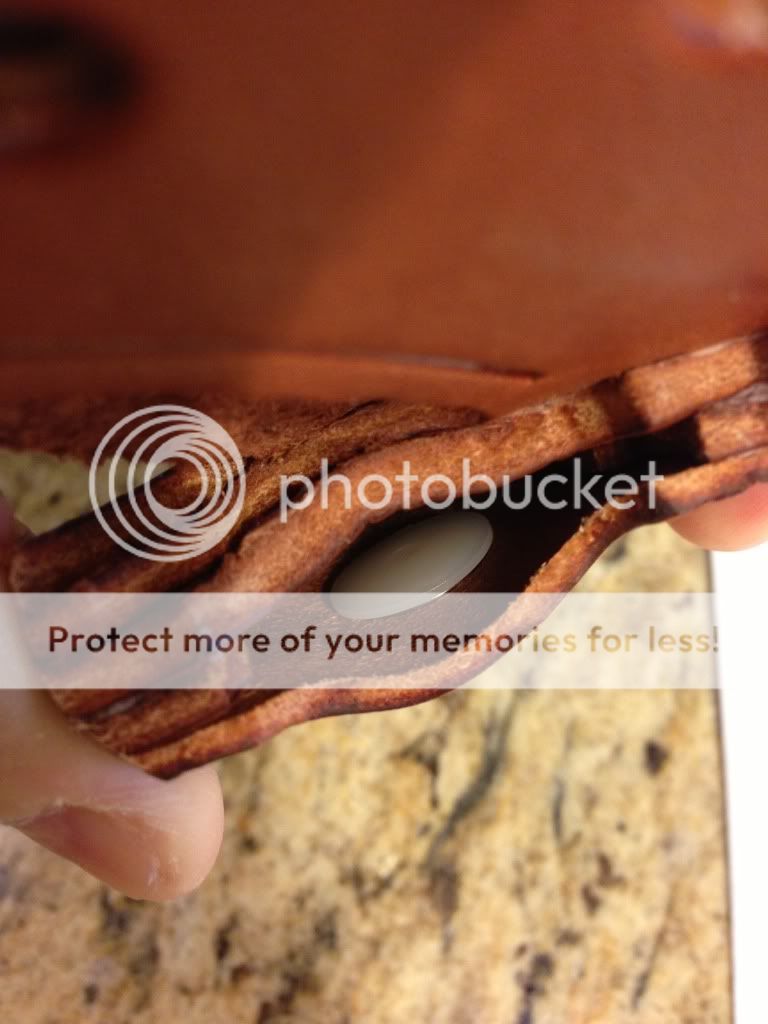

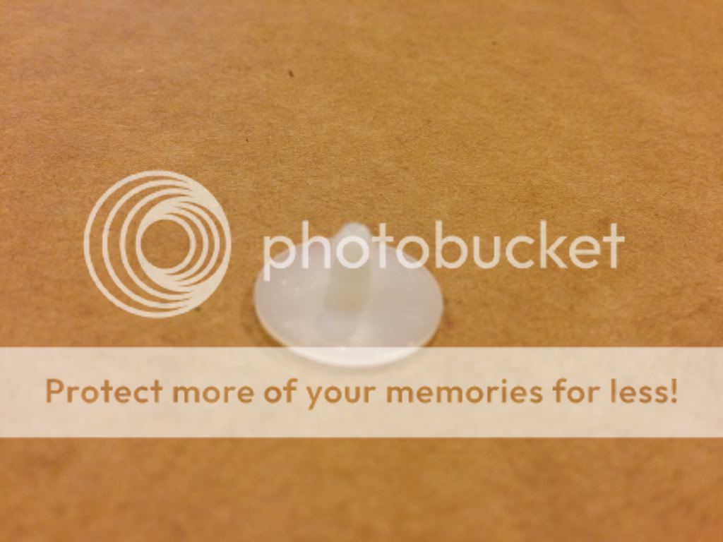

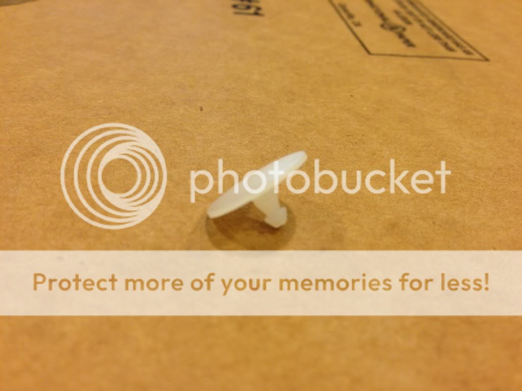

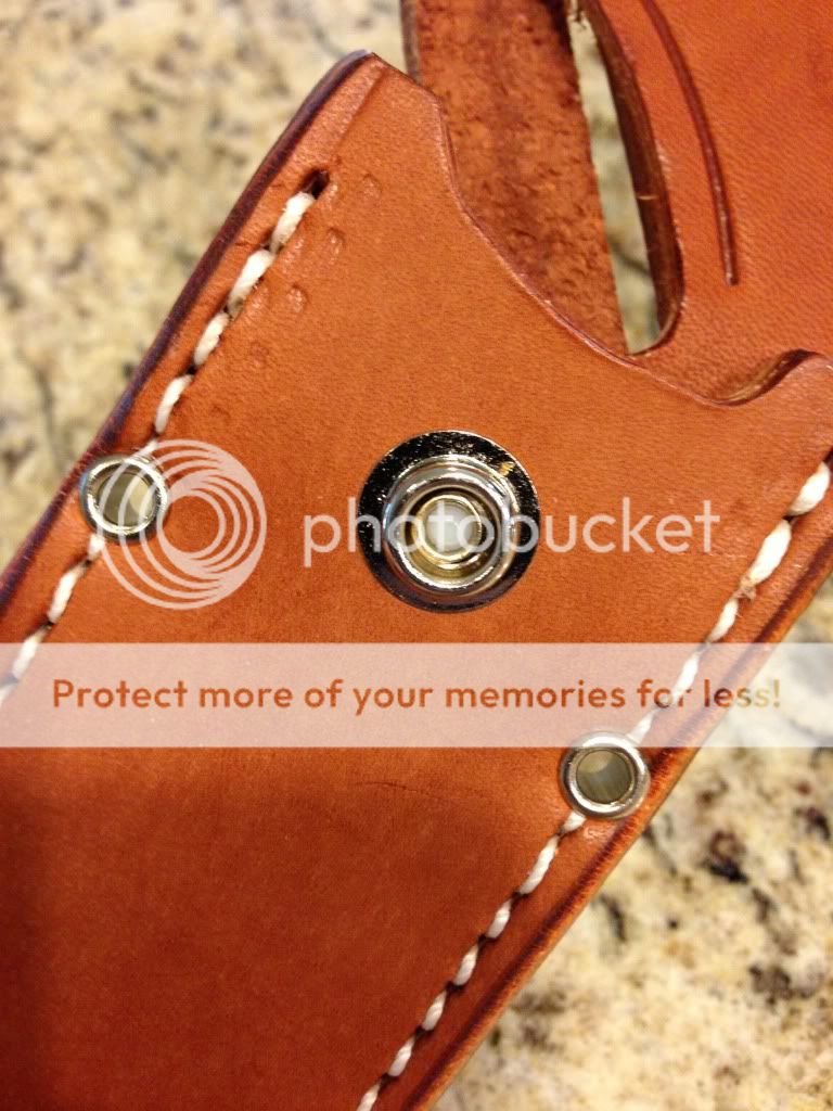

Let me show you a pic of the inside of a Sharpshooters leather sheath for a Bark River knife I own. It does have these plastic caps that go over the button snaps. I tried to get the best view that I could of the inside of the sheath showing the snap, and the outside showing how the plastic button is going into the hole of the snap. I can't find where to buy these things. I will tell you that it takes up some space between the blade and the sheath, so it kind of makes the snap bulge out a bit. But it does not scratch your knife. If anyone knows where to purchase those I'd be interested.
**Edit** I might try to knock out the plastic cover so we can get a better look at it. I will post photos of that if I can do so.
**Edit** Was able to pop the snap out of the button! Added pics.

here is one for "plastic snap rivet" (for some reason the link doesn't open up by itself, you have to press "enter" after the word "rivet" ):
https://www.google.ca/search?q=plas...mozilla:en-US:official&sa=1&tbm=isch&imgdii=_
The first picture looks a lot like what you want.
Mcmaster-Carr sells some (scroll down to "snap shank"):
http://www.mcmaster.com/#standard-nylon-rivets/=o264q4
Reading the description, it seems that a well stocked art store would have them in the cardboard aisle to use as pivots.

That nylon snap cover is exactly the one I got a handful from Sharpshooter Systems a while back. He sent me a handful as a favour - and I don't think he was selling any - but nontheless - they work great.
