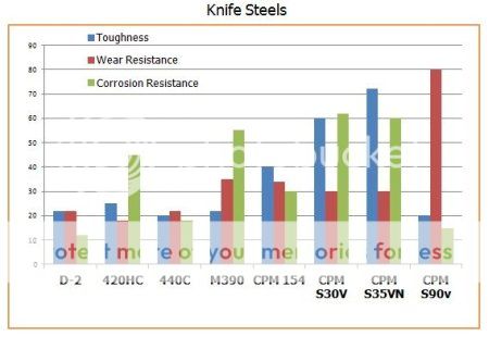

This may help. Courtesy of 'Simply Tool Steel'.
Thanks a bunch guys. I did do some searching on my own, but jut wanted to hear it from the bladeforums experts. The knife steels chart from A.P.F. was just what I wanted so thanks to you I had considered asking Mr. Demko if I couold get it in a different steel, but it looks like CPM 154 shold be pretty good stuff. Just wanted to make sure I got the right thing since this is THE folding knife for me.
I talked to the salesman in the Crucible booth at the Blade Show. He said that the recipes were the same for each, but that the grain size was smaller in the CPM 154. CM 154 was a high purity steel to start with so there is probably no significant gain in purity going from CM 154 to CPM 154.
A.P.F.- Do you know where Elmax fits into this chart?
Pretty sure that Elmax will only be under M390 and S90V on that chart for edge retention.
