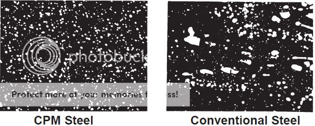

CPM process produces a superior end result (compared to conventional steel making) by reducing/eliminating alloy segregation (clumping of alloys) during the process of solidification (turning to solid during cooling). Both are/can-be processed into ingots during manufacture. This is beneficial throughout the process of manufacture (a better steel means better grinding, better heat treatment results, better finishing, better end user performance and future sharpening because the steel is more consistent throughout. Additionally, end results will be more easily repeatable making for better consistency throughout manufacture process to end result. . More on better sharpening examples below.
With convention process the molten mix (base metal and all added alloys) are poured into an ingot mold and cooled. During the cooling process various alloys segregate, to some degree, into micro clusters of like alloys (pockets of alloys in the base metal). The poured/cooled ingots are later forged (or hot rolled) into sheet steel for stock removal process or directly into finished product.
With CPM process the molten mix (base metal and all added alloys) is processed through a small nozzle with high pressure into a spray of tiny droplets that are rapidly cooled forming what might be considered mini ingots (tiny round solids of the alloyed steel) with much more even distribution of alloys (kinda like mini BB’s of alloyed steel in powder form). I have used Dippin’ Dots vs. traditional ice-cream analogy for illustrative purposes for others in the past (little pellets of goodness). This powdered alloyed steel can then be stored in bins for later use, including loading into forms that are then hot pressed (forged, but I believe at lower temperature than typical forging) into ingots. These resultant ingots can then be hot rolled into sheet steel for stock removal process. The grain structure of the CPM steel is much more even, producing a superior product.
When looking at cross section comparisons under a microscope it is easy to see the more even distribution of carbides in CPM steel. I will choose one alloy for an example Vanadium to hopefully illustrate how CPM is better to an end user (same would apply to any alloy in steel composition). With conventional process, the Vanadium carbides will be more segregated (clumped together) after cooling. These larger clumps can more easily fracture out larger matrix formations in grinding, sharpening and in-use reducing the longevity of cutting performance. By contrast, more evenly distributed smaller Vanadium carbides will not fracture out as easily increasing overall performance (the smaller carbides provide greater adhesion, and during grinding and sharpening will produce superior results. I will try to explain why this is using concrete as an analogy.

Hmmm ..., with regard to my use of the term "clumping" I thought I was talking about the distribution of carbides as referenced in my text and attached image. Those carbides in excess to what are consumed into the base matrix of the steel (I think the term diffusion - dissolved carbides into the steel matrix during austenitizing phase); the one's that give an edge that bite of sharpness and provide additional wear/abrasion resistance. Perhaps these might be referred to as secondary carbides, as opposed to the carbides that are consumed for properties like hardness enhancing (primary carbides). These carbides all being part of the "alloying elements" added to the iron to form the steel.
Photo attached again below for reference as to my comments here.
RE: My original comments (post# 11) "When looking at cross section comparisons under a microscope it is easy to see the more even distribution of carbides in CPM steel."
Expanded capture of previous image to illustrate, note blue underline (that was not part of the previous image, but included here in a screen capture of where I got the earlier photo).
Image above: CPM (Crucible Particle Metallurgy) or PM (Power Metallurgy non-proprietary version of CPM) or SPF (Spray Form) carbide distribution is much less segregated (less "clumping" aka more evenly distributed, more surface area = stronger overall, providing greater edge stability).
