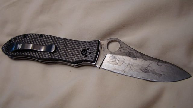

Just got my first m4 knife the spyderco mantra 2. I know this is a carbon steel but I sort of tried to patina it the natural way of leaving it in an apple for half and hour the blade got stained with rust orange in some spots not a black patina like I've had with super blue and other carbon steel. What do you guys do? This is my new favorite edc so I'm trying to keep rust away with handling it a few times a day.

I've never bothered trying to patina M4...but, in my experience with other knives, an apple doesn't do much in that regard. If you simply want to straight up force a patina, clean the blade thoroughly...then wrap it in a paper towel soaked in vinegar for a while.

I have done all of the above to patina 1095. CPM-M4 is an entirely different thing; but it discolors failry easily, so I'd expect those methods to work. If it gets too dark, or you don't like it, a dab of polish rubbed/scrubbed with foil will knock it back pretty well.

With less chromium and more carbon than A2, you can expect it to patina, but it may take a little bit of intent. Try dipping it in warmed vinegar for a length of time, it should promote the steel to develop a darkened patina.
(not my picture - photocredit LowCountryBurl)
