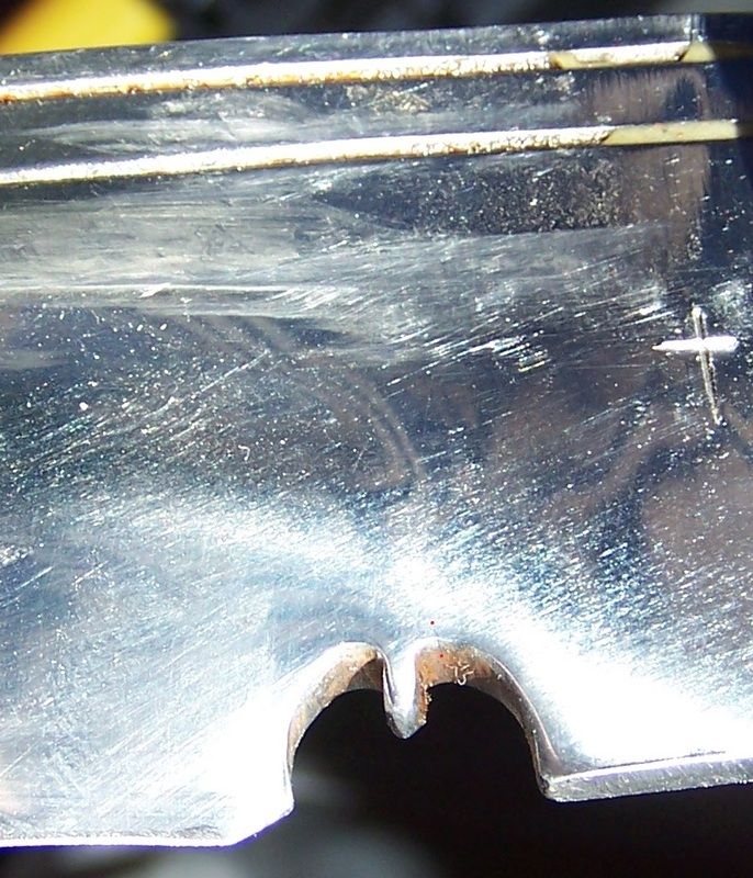

Himmmm. I can see very tiny black lines extending down into the blade from the base of the cho and yes all my khuks are/were HI's. Maybe it is not a crack I'm seeing but it looks like one. They are extremely fine and not long at all. Maybe 1 32" of in inch long. I'll try to get a pick of what I'm talking about.

I'm working on several pictures of these cracks everyone it telling me Im full of crap on. Very hard getting the tiny details caught on camera.....stay tuned.

Forge marks still left after polishing are also a possibility.
That's also what I think it is since he sees cracks in the photos I posted.
The inside edge of the Cho is a tricky place to work with for hand made blades. Can also just be file marks.

Ok I have tried all afternoon to get good clear photos and these are the best I can do. These "cracks" are extremely fine and hard to see. They are black and not a scratch like in the green circle on one of the pictures(I can tell the difference between a crack and a scratch). I'm willing to bet a lot of you guys have these and just don't know it or can't see it. I missed a lot of mine.
I marked the cracks with red dots where they end. Most of them can seen see on the side of the knife and also through to the inside of the cho so I know they go through the steel. This can see seen best on the Sanu cross marked Khukuri. The pictures consist of khukuris from the very early 1990's through to Vim being the latest I own from 2007-2009. All are HI khuks.
Maybe these are not cracks but they appear to be and yes, they were on most of my aprox 100 khukuries but not all. I'm guessing about 65-75% had this issue. I used many of them and never saw a crack move or had a blade failure. I'm not calling these cracks a problem or a flaw. I just sometime worry for no good reason(OCD) they they may fail one day and want to know if anyone has ever seen this or a failure caused by this. I forgot I asked about this years ago as posted above. I have been out of the khukuri game for a while but thinking about getting back into the knives again and revisiting the forum more and talking about knives and learning more. Sorry for the poor grammar...Out of time and have to go so I'm trying to speed post this with the pictures:

Well, i work aircraft structures and electrics and have about 20yrs of structures, so i know cracks in metal.
The photos are suspicious, however, one dimensional photos are generally only good for illustrating something already proven, rather than something for speculation.
I have never seen or heard of a complaint personally, nor heard of the outcome after making a warranty claim first....
If it were my knife, i use them hard and look them over well, and had i an issue such as you seem curiously concerned over but not curious enough to send to Bill to see what was going on, i would have taken it to work and cleaned the area thoroughly to get to fresh steel in all 3D and then done a dye penetrate inspection if looking at it with magnification did not settle the issue.
And if i had determined it a crack, i would have sent it to Bill with extreme curiousness as to why in the world these cracks on 60%-70% of knives owned were propagating across the grain rather than with the grain and why they did not run fully side to side of the blade first, before propagating on a corner exclusively.
Although suspicious, since the mystery marks do not seem to be following normal patterns of cracks, they would be assumed surface marks until proven otherwise..
And if i had determined it a crack, i would have sent it to Bill with extreme curiousness as to why in the world these cracks were propagating across the grain rather than with the grain and why they did not run fully side to side of the blade first, before propagating on a corner exclusively.
Although suspicious, until proved otherwise, since the mystery marks do not seem to be following normal patterns of cracks, they would be assumed surface marks until proven otherwise..
Have you even cleaned these to fresh metal to see if still there or reappearing? I'll not ask again why posted rather than dealt with through normal channels first....this latter part is akin in many minds to badmouthing a wife before discussing matters with her.
