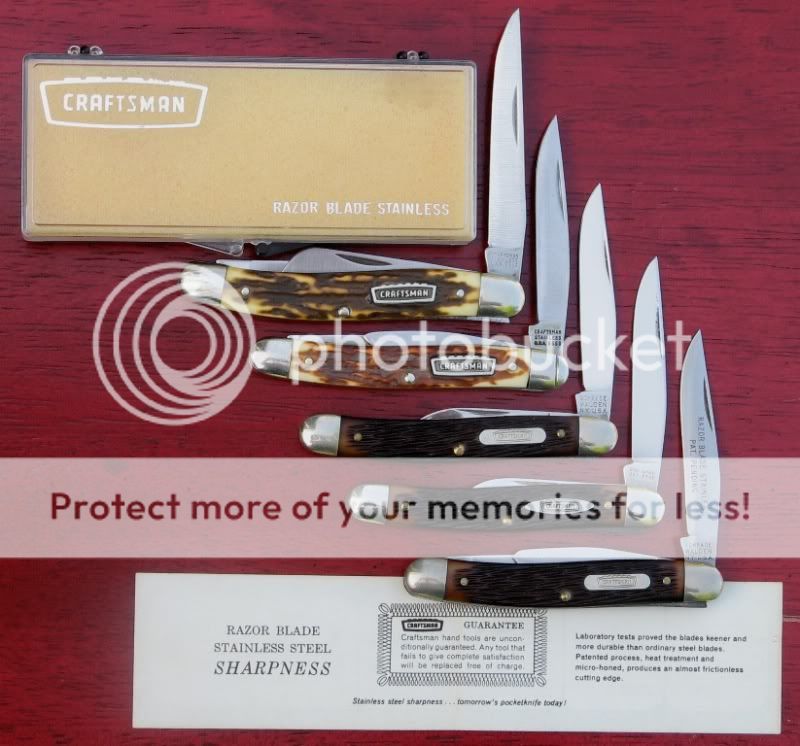

I have a small collection of Craftsman knives that fit in that second category. All have the "Crown" shield. Some on the shield, and some are the shield. All are Schrade Walden era, which fits the 1959-60 date. I suspect most of these knives are a little newer than that.
[/URL]Some are stamped CRAFTSMAN, others SCHRADE WALDEN. The bottom knife goes with the plastic container, as does the paperwork. The Sears, Roebuck, and Simpsons-Sears might help with dating. For reference, a Craftsman 9552 = Schrade 897UH, Craftsman 9553 = Schrade 855 (no UH equivalent), Craftsman 9541 (two blade jack) = Schrade 855 as well. Both the two and three blade Schrade Waldens are both marked 855 on pile side.
I agree with Codger, information for dating of the Craftsman is as difficult if not more so than the Schrades to find, and I'm sure he has spent countless hours compared to me. In this photo, all master and secondary blades are stamped STAINLESS with the exception of the pen on the 9541 (second from bottom). All handles are Delrin.
Sometimes showing examples of the knives are the only clues we get.
Sears #9552 - SW 825RB (1966)
Sears #9553 - SW 855RB 3 bl. (1966)
Sears #9541 - Ulster 50 (1964)
These were the first years these pattern numbers were used for these particular knives. We know that IKAC trademarked "Razor Blade Stainless" in 1966 (USPTO #72184925)
Always confusing, the Sears #9541 was first used on a Schrade Walden H-15 Utility Hunter Fixed Blade (1959).
Michael
EDIT: OOPS! I just went back to the TESS search to refresh my memory. The trademark issued March 1, 1966 but was filed on January 20th, 1964. In the declaration it states first use in commerce as December 1963.
Hal, what a fine Schrade collection you have ! inquiries by others so frequently results in you posting great pics not only of knife in question, but it's variants as well. so this is a Thank You for all these posts. v.helpful and enjoyable ! roland

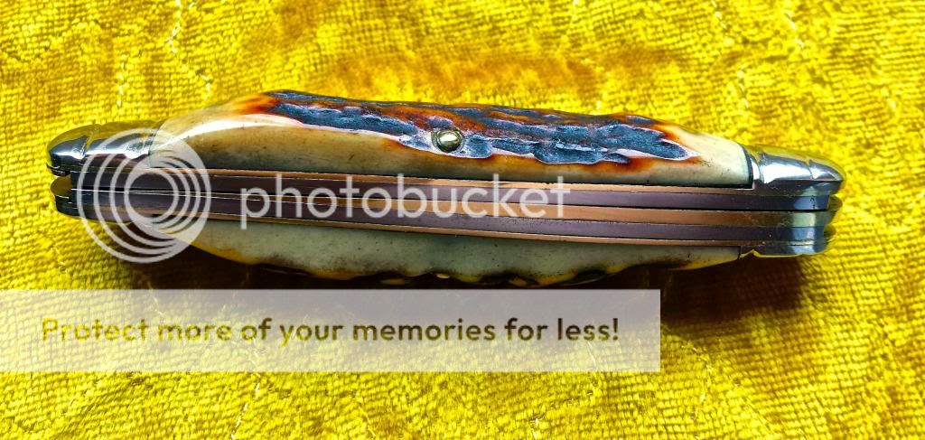

I remember seeing Craftsman Knives in Sears when I was growing up, but they were rather plain in appearance, and never caught my interest until I came upon this one in an eBay auction, and had to have it immediately. This knife has some of the most gorgeous (and perhaps the most gorgeous) fat stag handles I have ever seen on any knife anywhere. They did not include a shield on this knife, and I am sure a shield would have served no purpose other than to cover up some amazing stag. It also takes an incredibly wicked edge, leading me to believe it is made by Schrade (all my old Schrade knives take this same wicked edge). It is marked Craftsman USA 9554.
I have no idea how old it is, but it is in amazing condition (although I did clean it up a bit), with both the main clip blade and coping blade still exhibiting solid walk and talk. The small clip is a bit of a soft walker, but still snaps shut. I have been using this as a whittler, which is what is was meant to do.
Great knife DMA - congrats on the score and thanks for the pictures.
That stag really looks great.
