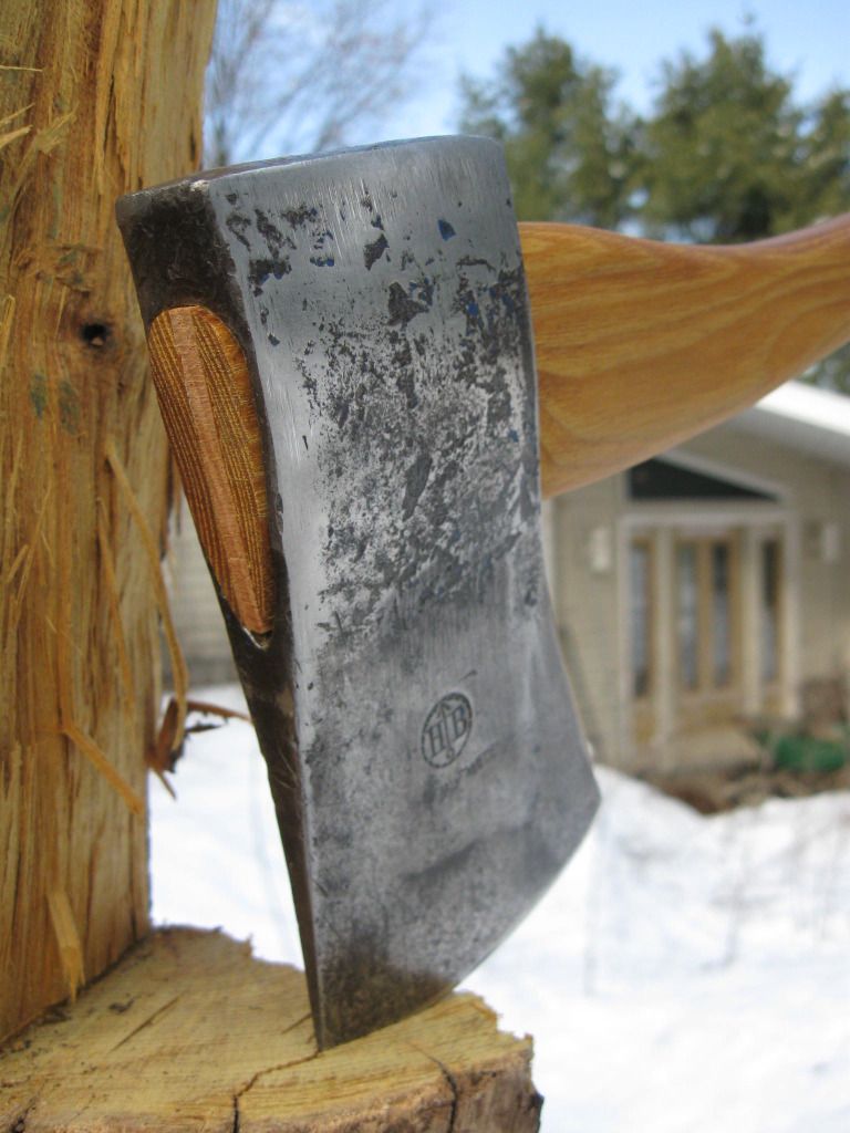

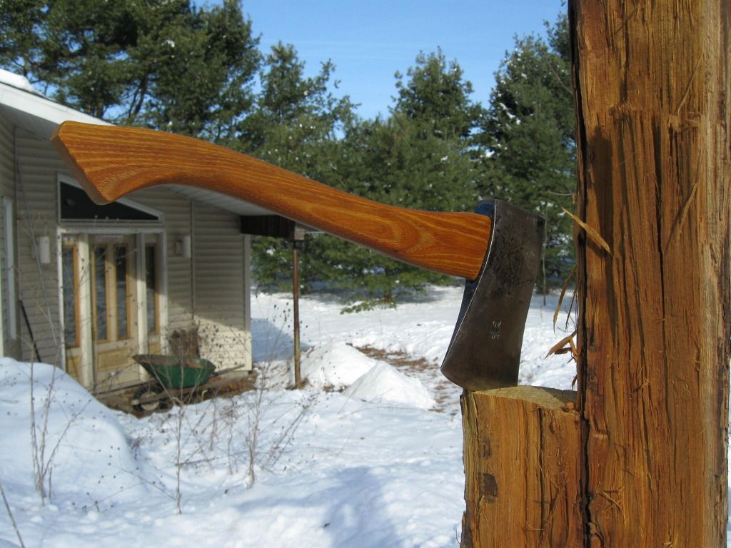

I don't know the best way. I've only made a couple of handles. Both were radially split out of logs. This gives the most stable blank. Here's one I've posted before. It's Osage Orange shown with the log I used in the pictures.
The axe came with a handle that needed replacing. I flatened the blank, used the old handle for a template, and cut it out on a bandsaw. The rest of the shaping was done with hand tools. I made the wedge out of red oak. There have been dicussions here on handle and wedge material, well worth looking for in previous posts.
