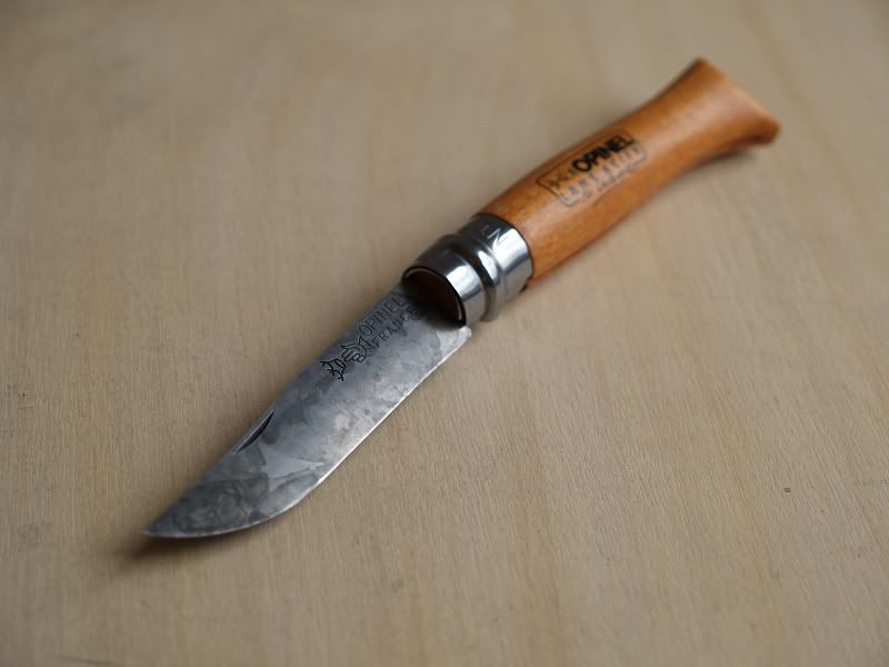

Here's one with lime patina after about ten minutes:
