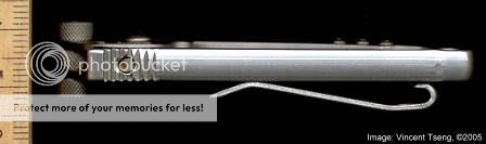

I got this on sheer looks and cleverness.
When closed it looks like a piece of jewellery - even when open it still looks interesting.
I like the size of the Snap Lock 2 it seems just the right size as a "show piece" - it is probably less practical than the full-sized (original) Snap Lock - but then I didn't really get this for its pure utility. However having said that this smaller Snap Lock 2 is still usable as a knife and doubles a a "cute" piece.

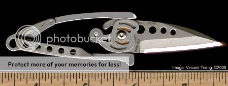

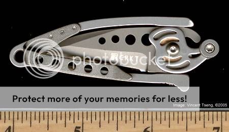

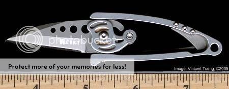

The design by Ed Van Hoy is very clever. Utilizing the frame handle as a wishbone like spring for the locking mechanism of the Snap Lock 2.
With a bit of practice I was able to open the and close the knife quite easily one-handed. It is not a particularly fast operation, for me - but it is quite easy and reasonably safe. I could not open and close the knife well left-handed - I'm sure it's not impossible - but I could not find an easy and safe way for my rather clumsy left hand.
The frame handle is both the pivot and the locking mechanism for the knife. On the insides of the frame handle the holes are rectangular and the blade pivots have the corresponding rectangular profile to fit into the holes so the knife blade locks both open and closed. The button actually rotates the floral/leaf shaped "lever" that levers apart the spring frame to allow the blade to rotate and the spring frame then closes on the rectangular piece of the pivot to lock the blade open (or closed)
I have the original full-size one, and yeah, it's not exactly ambidextrous... but, if you want to use it left-handed full-time, you can switch the pocket clip to the other side, then it works just the same as right hand.

oh DoH! - I didn't even think of changing the clip side :o . Thank you!

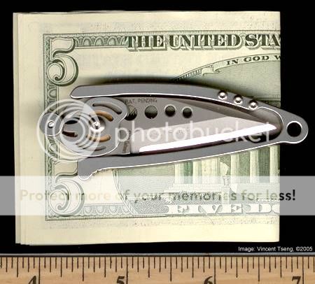

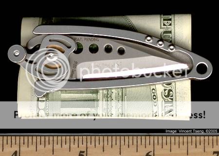

One of the suggested uses of the original Snap Lock was as a money clip.
I think the Snap Lock 2's smaller size may actually make it better for that purpose - it's very good for US $ bills folded in half -
but even better if one prefers the 1/4 fold (where the original Snap Lock would be too big) -

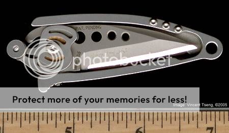

The 1.75" blade steel is nothing to write home about - it's AUS 4(!) I knew nothing about this until I looked it up in the CRKT catalog - it has less than 0.5% carbon content - close to 420HC.....
Another small point that's worth noting there is the possibility of some up-down play - it's inherent in the design of the spring frame. But if one were to hold the knife pinching the frame together (a natural hold for me on this knife) - then any play is eliminated.

As for the blade play, it's sorta self-correcting: the tighter you grip it, the less play, and the more secure the blade is. Pretty clever, really. Although the size of the pivot pins precludes the sort of uses YOU like to put knives through! ;)
