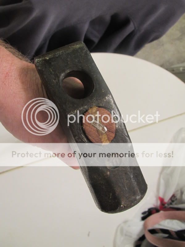

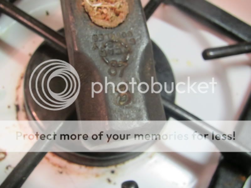

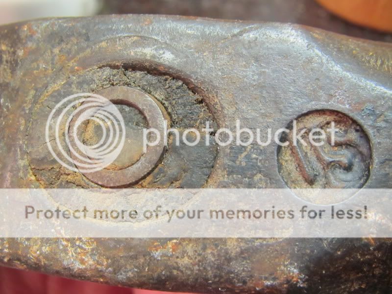

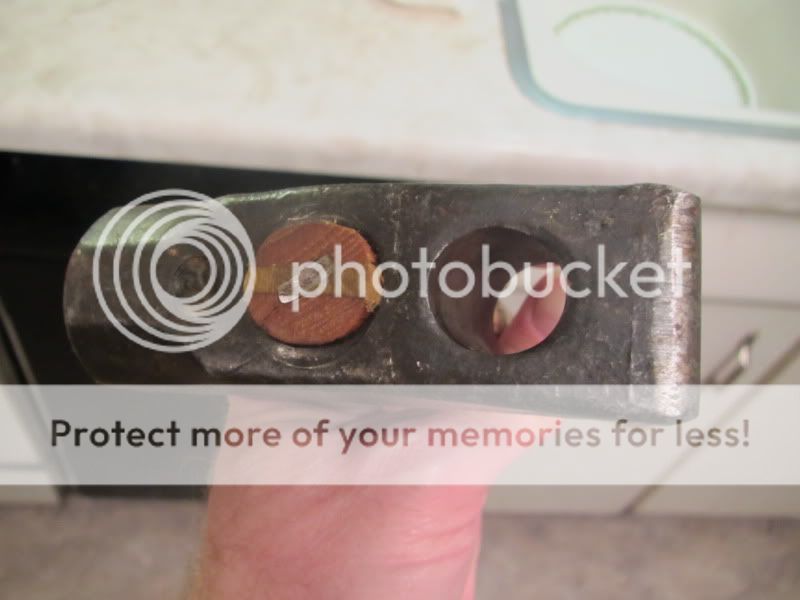

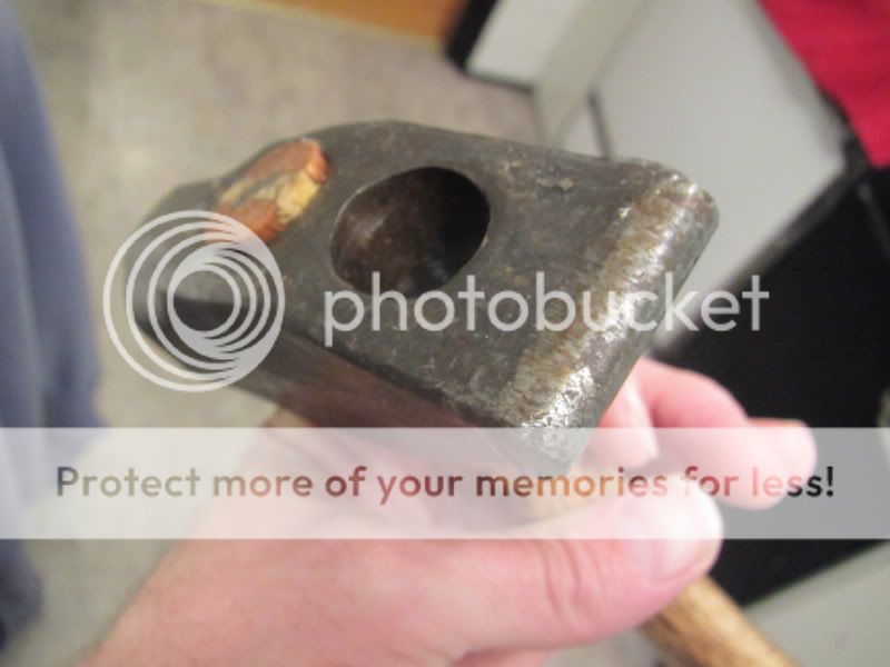

Thanks for solving the hammer mystery everyone. Here are the pics of the hammer in question just in case someone does a search in the future. Some were taken before I attached the new handle last weekend. I've never seen anything with so many numbers and stuff on a head before.
