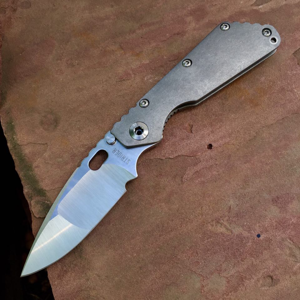

I am looking to get a 7 and bolster it and do something custom to it to give it a 6 look but I have a few questions. The knife will be a shtf edc type folder.
Should I do a zero grind ?
How do you sharpen a zero grind ?
Could I get a more aggressive swedge?
Should I do serrations or buy a knife with them if it's going to be my zombie bug out folder ?
Any one have pix of their custom 7 or 6 knives they would like to share ?

Zero grind is cool but not an ideal for SHTF blade imo. It is the most fragile grind out there.

You can always get a regrind if you're not sure on the zero. Tom Krein does some of the best-all the other mods you should be capable of, with machinists experience. I would note that the zero grind is a pure cutter/slicer, it won't hold up to abuse at all. It is somewhat simple in that you can simply remove the secondary bevel to get it-pretty much like sharpening a chisel, without putting a micro-bevel on it. It is more a matter of how you sharpen, because I would guess, freehand would be near impossible. Practice on a cheap knife or two to get the technique down, and you should be GTG. Hope this helps.
