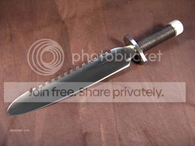

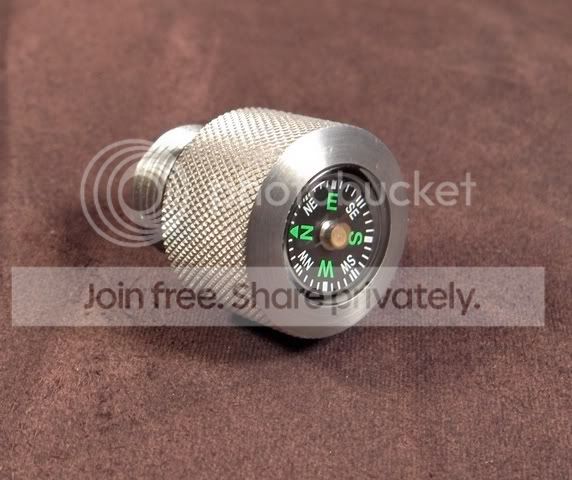

I have had a couple cheapo survival knives that were two piece and they both broke with a little use. A couple months ago I go an idea for a one piece integral that would be a forged/machined hybrid. It was made from a 1 1/8" chunk of wrecking bar (1080). The guard is titanium and the pommel is 2011 aircraft aluminum with a compass inbedded. The hollow handle is kevlar thread sealed with epoxy. On the spine are 1/4" saw teeth that are similar to chainsaw teeth and cut very aggresively.

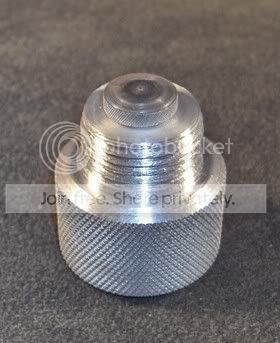

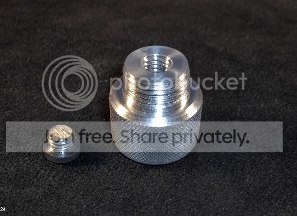

The pommel is also hollow and holds a couple teaspoons of magnesium thermite. The mixture can be flint ignited and burns much hotter then just magnesium shavings.

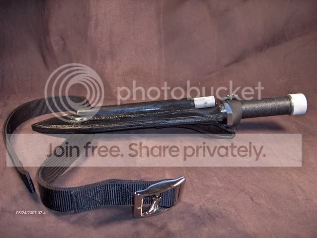

The sharpening stone is a 1/4" boride EDM stone that will also work on the saw teeth. The handle is magnesium so I can shave some off as an alternative fire starter. Att eh bottom of the handle is a small chamber that holds a mag-thermite charge when ignited it will also ignite the magnesium handle to function as a signal flare (on a stick).
I just found this forum and thought you guys might be interested in this knife/system. In a couple days it will be going with me up onto the glaciers of Mt Rainier. Hopefully I will not need it for anything more then a knife.
That looks pretty cool, almost looks like a Roman short sword. Take some pics of her in action if you can. Who made it by the way?

Awesome work that is a neat looking blade ya made. Could you get some pics of it chopping, sawing and doing any other work to see how she performs.
Thanks, this was a test cut on some seasoned maple I did while I was testing out what rake and pitch to cut the teeth. It cut real well before I heat treated the blade and teeth. Afte the test I increased the rake on the teeth by 2 deg.
On this knife I was not concerned with the visual flow or artistic impression. The entire design was based on what will work the best and not add to the weight. It is very forward balanced just for chopping. The teeth are stout enough I can hit them with a chunk of wood if needed to use the knife as a wedge or splitting maul.
It seems like the knife forums are overrun with pretty knives but I am always more interested in function. I enjoy forging and building art knives but sometimes all you really need is function. When mother nature is trying to kill you slowly with hypothermia it won't matter if the handle is burl or curly maple.

I'm loving that blade, man. I must admit, at first sight my first thought was that was one ugly knife, but then I looked closer and read your description. And then, just as always happens when I see a knife that puts function ahead of form, it became a thing of beauty.
I applaud you, my good man.

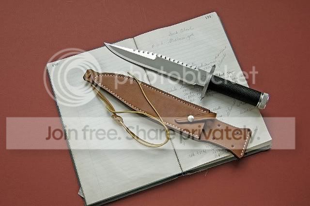

Thanks. On my first attempt I forged a bowie clip on it but it interferred with the saw teeth tracking right. With a regular spear tip all the teeth get utilized. My intentions were to base the concept on Jimmy Lyle's survival bowie that Stallone used in First Blood.
It is a very cool looking knife but the teeth on the clip point are un-usable.
