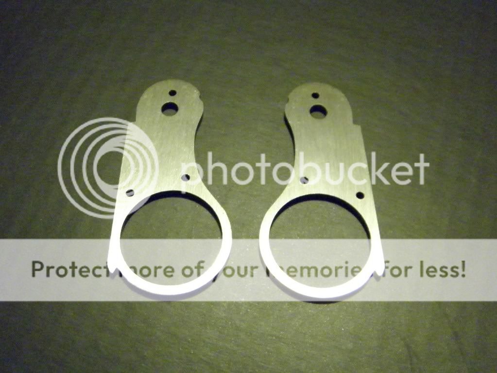

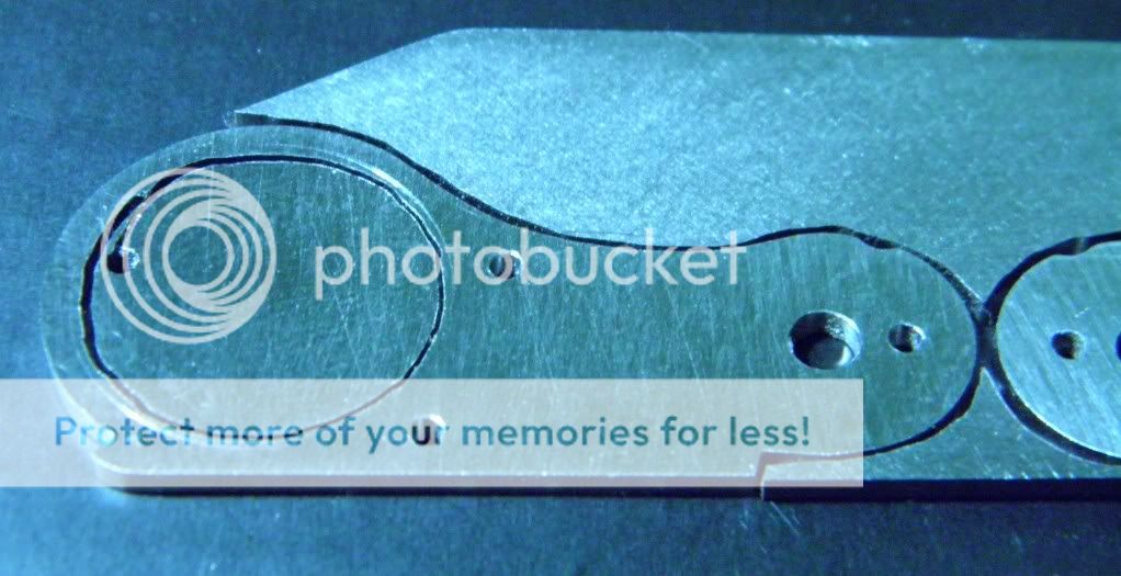

Liner lock cut for 111mm one handed trekker.
Small blade spacer in the horizontal vice I use to saw.

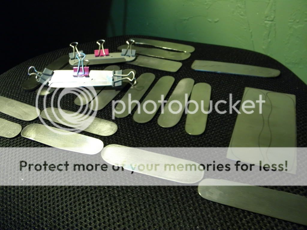

Scales and liners cut just to the right of the line and finished up with a belt sander and sanding spindles in my micro drill press.
2 piece SAK magnifier bezel in .063"
Have you got more info on those jeweller saw blades, please? Frank
+1... i was wondering if i can use a jeweler's saw to cut .125 Ti so i can have more control cutting a lock bar relieve. I was told by a few makers it would not work. If you found a brand of saw blades that works? I need to get them :-)
