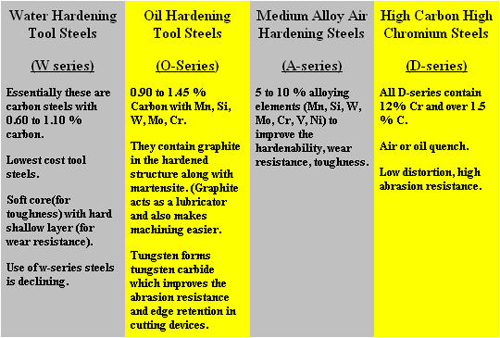

hello all. this is just a quick little question. im looking at a magazine and it mentions D2 tool steel and then just D2. both are at a different Rc hardness, just by a little but the fact they are different raises a question for me: is there a difference between D2 and D2 tool steel? im looking at some Queen knives and am saving up for a summer treat and knowing if there is a difference would be a bonus. thank you for the oncoming input- Herbs
Rc has to do with heat treatment, not the type of steel. Any steel might be heat treated for more strength (lower Rc) or longer lasting edge (higher Rc). This is a drastic oversimplification but gives the basics.
so same steel could just be treated a little differently but still considered same?
Exactly. The steel is just part of what makes a knife cut. Heat treatment, blade geometry, and blade shape all play a role in a knife's effectiveness.
- Christian

The term "D2" is a designation by the American Iron and Steel Institute (AISI) for a steel alloy with a specific composition. As long as the steel has that composition, it meets the specification and is called "D2". Hardness is not part of the specification requirements.
D2 is classified as a "tool steel".

Here are a few links for you to read through. Read all of them, then come back and ask more questions. Steel can be confusing and the terminology is totally different than anything most people talk about every day. Sometimes you are going to have to just take stuff at face value and figure out the details later when you have the knowledge for them to make sense. It will start to make sense, I promise.
http://info.lu.farmingdale.edu/depts/met/met205/toolsteels.html
http://info.lu.farmingdale.edu/depts/met/met205/alloyingeffect.html
http://info.lu.farmingdale.edu/depts/met/met205/carboneffect.html
