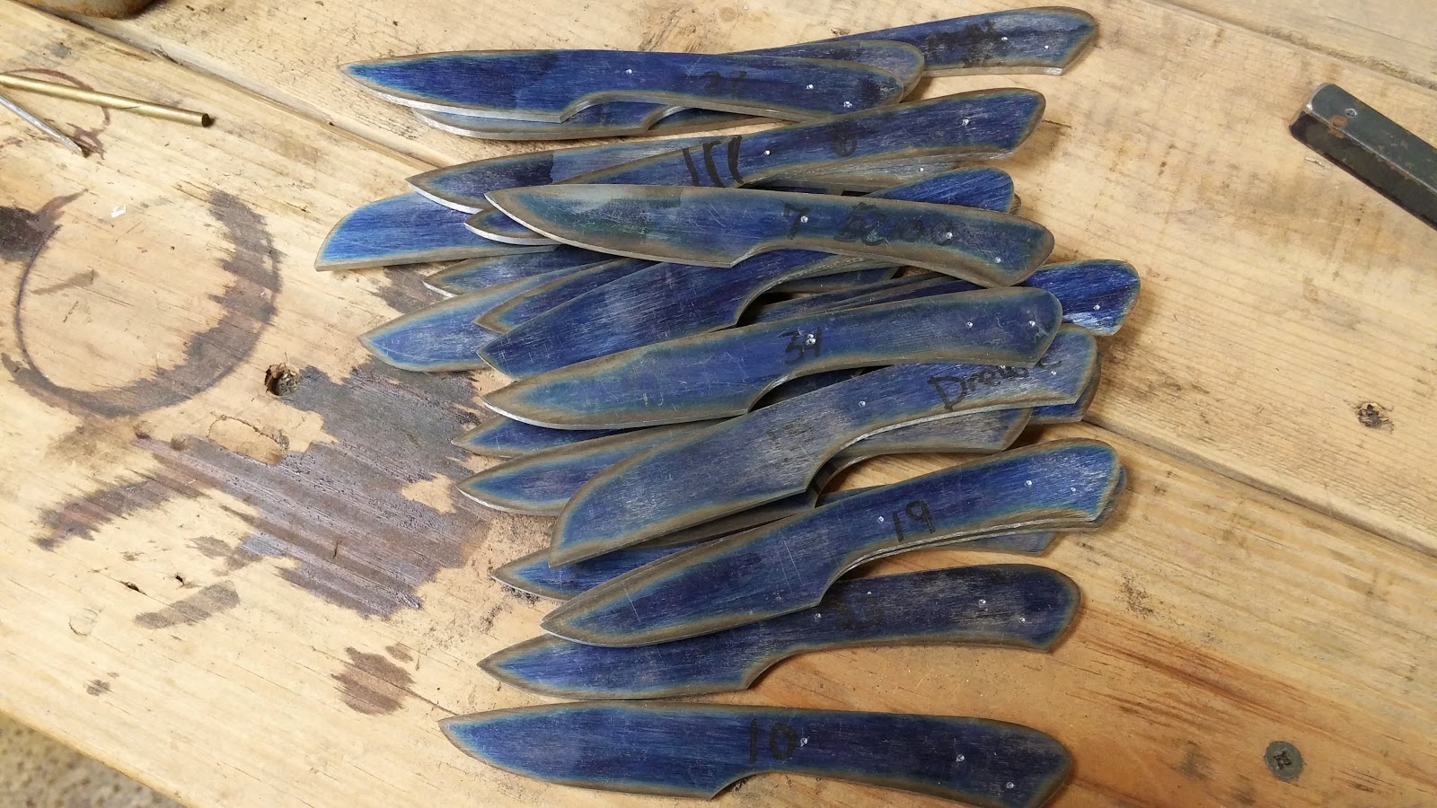

Small update. Got the first four profiled completely and almost all the rest blanked out. I got my system worked out for profiling, so my speed will increase and I'm planning on having the rest profiled out and drilled for handle screws by the end of this week. Profiling is just plain grunt work, but I've got it figured out how to move more quickly now. I may be talking out of my butt here, but I figure 8 hours to profile them all, 8 hours to rough grind them all, heat treat, then who knows how long to do all the scales. No one say "as long as it takes."

Starting to look like they are going to turn out to be knives! I know there are numbers missing. It's not so much sequential order as they are customer numbers. Every number matches a sheet of paper in that leather notebook over on the right side. It's difficult to keep everything straight sometimes.
The second picture is all the profiled blanks in a pile, all center punched and ready to drill for handle fasteners.
Drilling, jimping, tapering the tangs, and grinding the bevels and they'll be ready for heat treat.
Looks like a lot of work! Thanks for sharing the pictures.
It was a considerable amount of work, but I have my system down now, so it's not as bad. I'm hoping in the next year to add a second grinder set up to do only profiling, which will greatly speed up production even more. I can't wait to see the jimping and the holes drilled. They will really start to take on a life of their own then.
