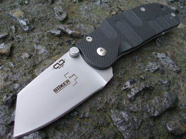

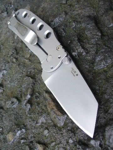

I've always been a fan of Wharncliffe type blades and decided to apply the WHART concept to a Trance I had on hand. Here is my interpretation of Chad's WHART:
Blade is about 2.050" long
Added a full convex swedge to front edge of blade
Bead blasted and stonewashed blade, lock side and clip
Satin finished thumbstuds and all hardware
Replaced teflon washers with phosphor-bronze washers
Added a bead blasted carbon fiber front scale

What do the new washers do for the movement of the blade?
Thanks :cool:
The teflon, while slick, is quite compliant, and gives a "squishy" side to side feel to the blade. The p-b washers firm that up. Not quite as low a coefficient of friction, but for thumbing open the blade, more than sufficient.

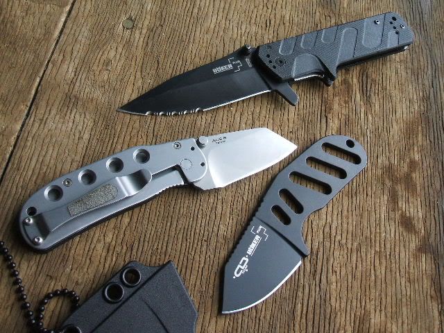

Among some "family members"...
It's amazing. Non-Knife People don't freak out when it is used in public, urban office friendly, and in the SD world...it's hard-ER to...uh...well, we'll just not talk about it here.;)
