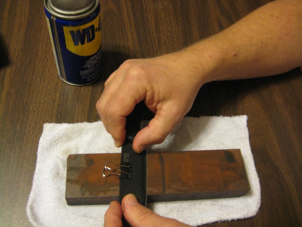

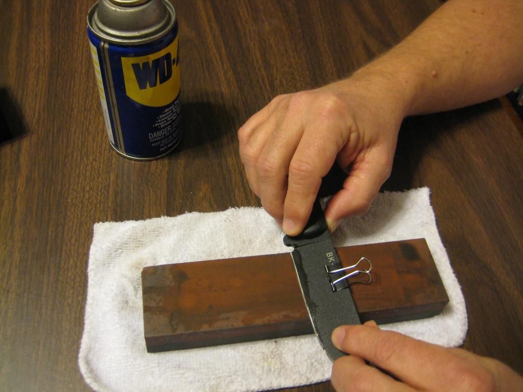

You probably already own some clothespins and binderclips :)
For anyone learning to freehand, consistency is the name of the game so here's a tip that can help you out. A fine India stone is inexpensive and gives a great cutting edge. A lot of makers and knife men use them (Including Ethan and Jerry Fisk). A little WD40 and you're ready.

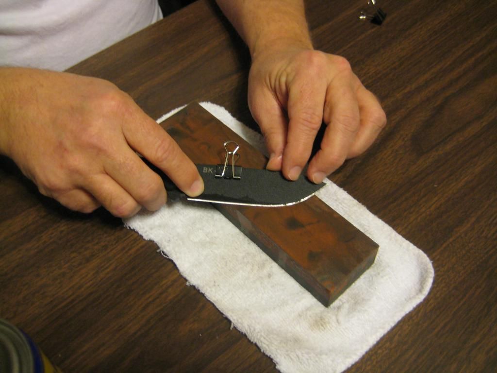

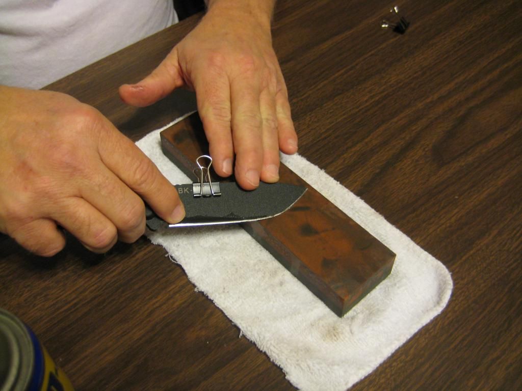

Now, here's the tip. A 1/4" binder clip gives you a 22 degree angle and that's not too shabby. It will let you maintain that consistent angle until your technique is good enough to go without it.
It will get you to about here:
Then you will have to lift the blade a bit to maintain the angle.
This will give you a razor edge the first time. Give it a try. :thumbup:

Could you put a second one towards the tip, so you wouldn't have to lift it?
Do you mean lift the guide?
I wouldn't change its position,
the clip/guide is there to let you know when your angle is too low,
as long as you're close to the angle, blade will get sharp
but the easiest way to figure out what works is to try it with your practice knife,
watch your hands, watch the blade/stone , gotta do it a few times to figure it out
