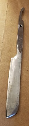

I've decided on a few hybrids of the ideas here
I used a basic drop point design with full tang. I made a primary bevel up to about a 1/2" from the spine for maximum thinness without loosing the weight and balance of the tang. It's a flat grind to nearly edge thickness. I drilled the pin holes, and balanced the blade to just in front of the plunge line with some small weight reduction dimples on the drill press. The dimples are in the tang between the two pin holes.
I made a nice distal taper

As mentioned here, except the distal taper starts about 2/3 the way toward the tip for a thinner and lighter profile at the tip for finer work. I feel that 1/4" blades tend to be good for chopping but nothing more. So having a tip that is very thin and profiled will give more ease for doing food or drilling in the wild.
I differentially treated the blade, the lower half of the blade from edge to mid point on the primary bevel was fully treated with a final plunge in oil for the spine. I did 2, 2 hour tempering at 450 to bring everything to about 58 rockwell with the spine nearer to 54-55 for some flex.
I tested the blade at a local metal supply, the mid point of the harder tempering sat at an average of 57 rockwell, with the spine and tang (4 point test) averaged 55 rockwell.
