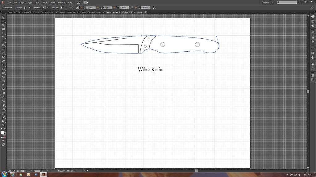

I sketch by hand. Drawing is not a problem for me. I then scan it into the computer and trace/tweak lines and proportions in a vector graphics program (Adobe Illustrator). This way I can print the designs out at different sizes until it fits my hand properly. I can then trim and mount to a piece of Masonite hardboard in order to make a template.

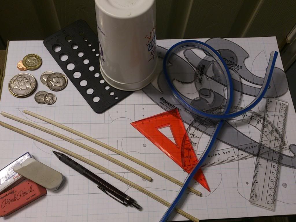

I posted this picture before but here is what I use.
I use the large french curve, the plastic cup lip, coins, and the rt triangle the most. Don't really like the flexible curve. The 3/16" wooden dowels are the best thing I've found to get big radii, increasing/decreasing and constant, for the spine of the knife and for sori on tanto and kwaiken. I used to cut notches in the ends and used a string with knots to adjust the curvature. Now I just bend a bunch of them and pick the one that matches what I want.

I recently added that post and photo to the standard reply
Great summary, and the plastic cup is a little bit of genius.

I see I'm not the only one who relies heavily on a drill gauge, pocket change and various cups. I often find them quicker to use than an actual compass.
