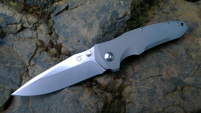

Really, the knife is gorgeous. It is definitely a unique design, there are hints of other designs clearly visible (a lot of CRK Sebenza and Umnumzaan) without being a direct copy of anything.
The blade shape is unique, something of a drop point with a large thumb rest area at the spine for choked up work. The handle is large but comfortable, made of huge slabs of bead blasted titanium.

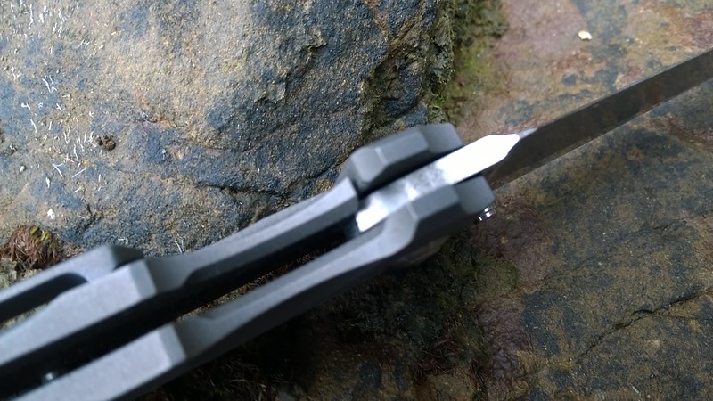

The action is smooth and the lockup is slightly early but rock solid. No blade play what-so-ever. The lock is smooth with no stickiness at all. Interestingly, it uses a PB washer on one side and a cheap looking black Teflon washer on the other side, I plan to source a PB washer for the other side to see if it will stay smooth, because the Teflon washer doesn't look all that great. Blade is centered perfectly, and when I did a tear down it recentered perfectly without any work from me, something that not even higher end brands have done for me.
The blade is surprisingly thick stock and claims to be S35VN. I have no way of proving it, but they do post steel certificates on their shop site and we know that Crucible has shipped S35VN to China, and of course Kizer has been using it (with maybe an imperfect heat treat). So I have no reason to not believe that it is S35VN.

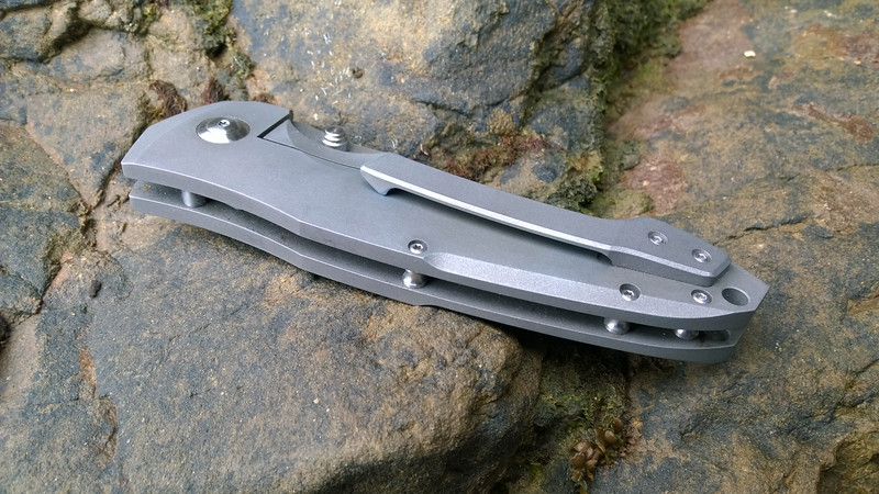

The fit and finish is surprising, but the detailing and finish work isn't quite as high as I've gotten from Kizer. Still, for an unknown brand trying to make their own way for the first time, it's really pretty good. My only real complaint is the pocket clip is very tight and not very well designed at the point, it grabs my jeans and doesn't want to let go.

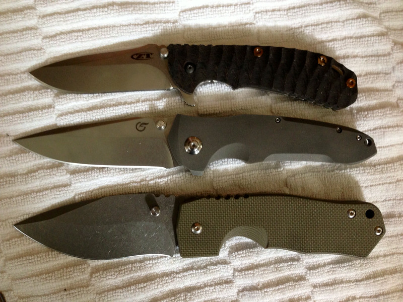

I need to get some comparison shots, as it is not a small knife by any means. The blade is about 4", for instance. It's close in size to an Olamic Wayfarer. But it carries very nicely.
