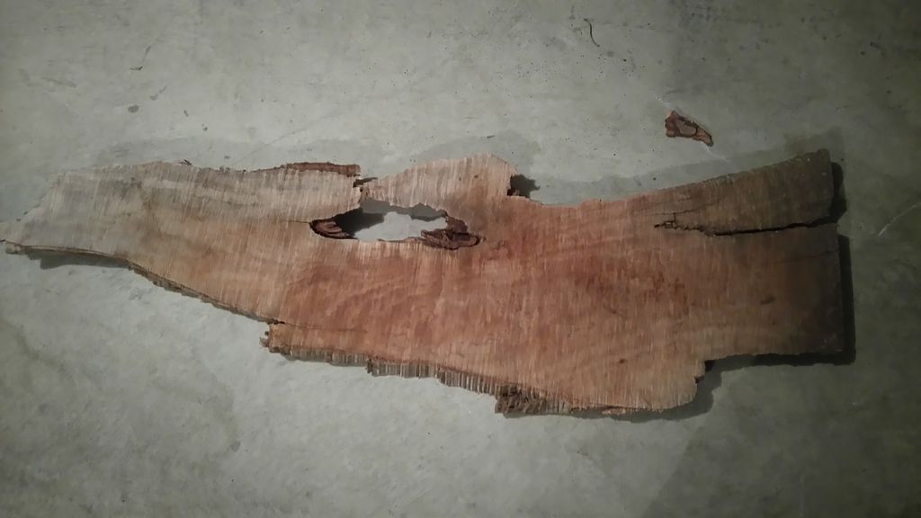

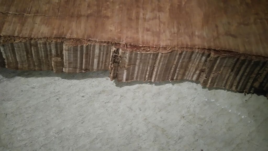

Well the first board is processed and on the way to Mike from WSSI. I didn't take any pics of that one, but I will take some pics of the finished product. I got 32 blocks out of it!
Here's the second board. It has some cracks in it, but it has some promise. Looks like some nice curl!
