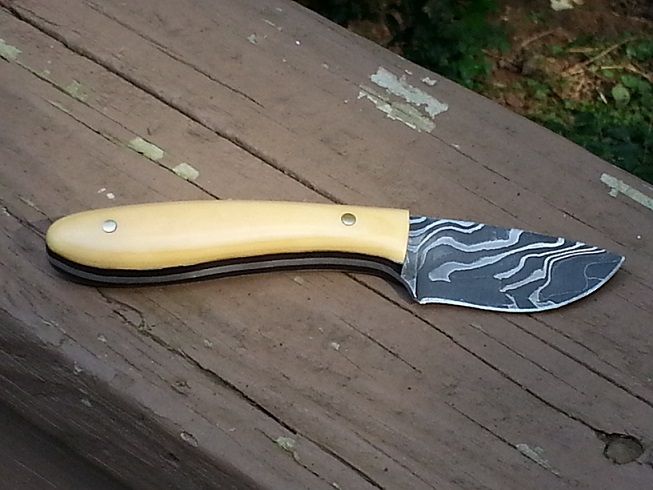

Here's my example of my own semi-custom EDC. I used a blade blank from two fingers knife co, set/shape/polish my own handle scales, and make my own sheath. It's not a pure custom because I (personally) didnt make the blade, it's not a production cause I assembled/finished this on my work bench. I call it semi-custom because of materials/parts used and how/where it was constructed.
