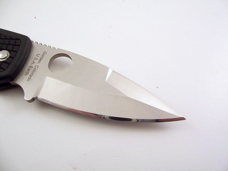

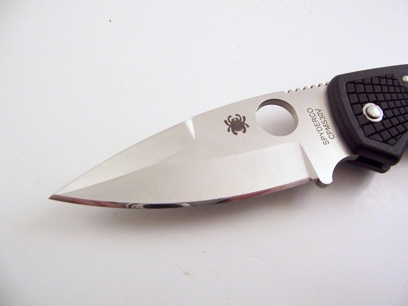

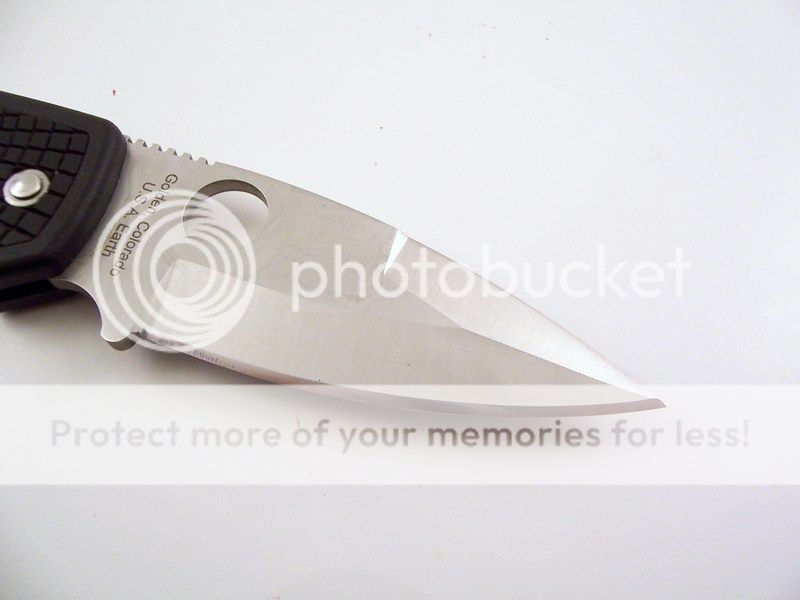

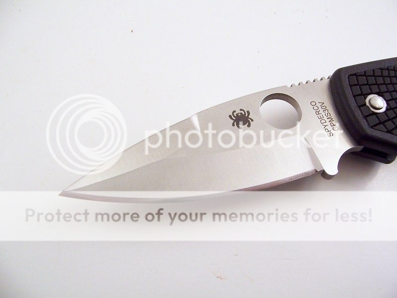

I love the Spyderco UF stone and you will be very surprised with the finish you can get going from the fine to ultra fine. Not only will it yield a close to perfect mirror sharp edge but it's a great stone to maintain an edge with that has been pushed past were just a strop alone can fix. The two pictures below are from an old post of mine. But you can see what can be achieved when going from the fine stone to ultra fine.

Is only jump between those edges fine to UF, or did you use any other stone in between the two?

Nothing in between. That's going from fine to ultra fine.
