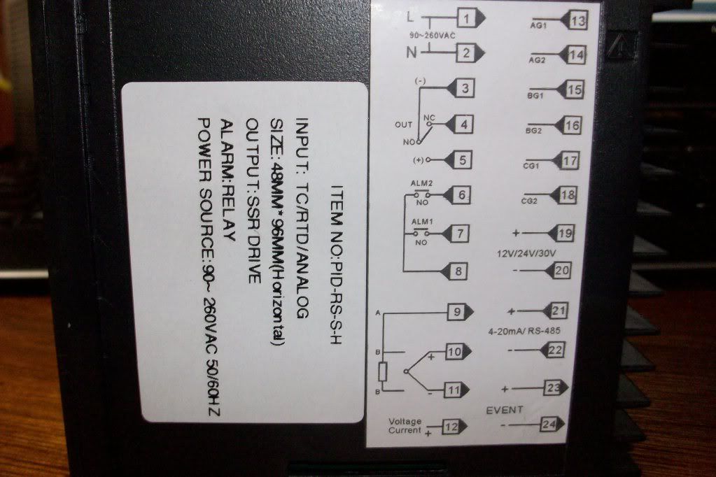

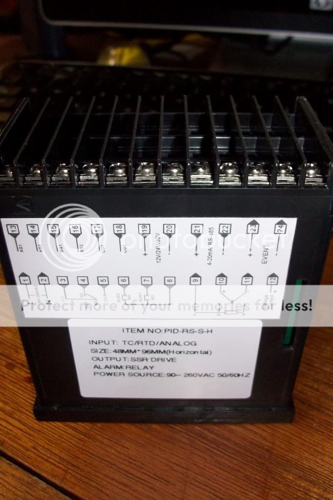

OK, I got the kit yesterday from the ebay thread and have more questions than answers. At this point I think I should have gone with a better controller because I can't find ANYTHING on this model of controller. I asked the seller about a wiring diagram and he said it's on the controller. I suppose it is... I can read ancient Greek, but I am lost in this!

2. I have no idea how to wire this controller. It looks like the thermocouple should be wired into 10 & 11 but that's all I'm sure about.
I assume 1 & 2 connect to the power supply, but it looks like it will only connec to 110v since there is only one L rather than two?
3. Which slots on the controller goes to the SSR?

The wiring of your PID is different from the diagram.
1 and 2 are the 110VAC power to the PID
10 and 11 are the TC from the oven ( 9,10,11 if using an RTD TC)
3 and 5 appear to be the SSR output
there is no need for that relay...a SPST switch will turn the PID on and off.

Wire it exactly as the diagram, only replace the relay with a SPST switch.
Also, while the socket as shown works fine, I prefer a socket with a neutral and a ground. I know they arevthe same, but is good wiring practice.The neutral would go to terminal #2 on your PID.
