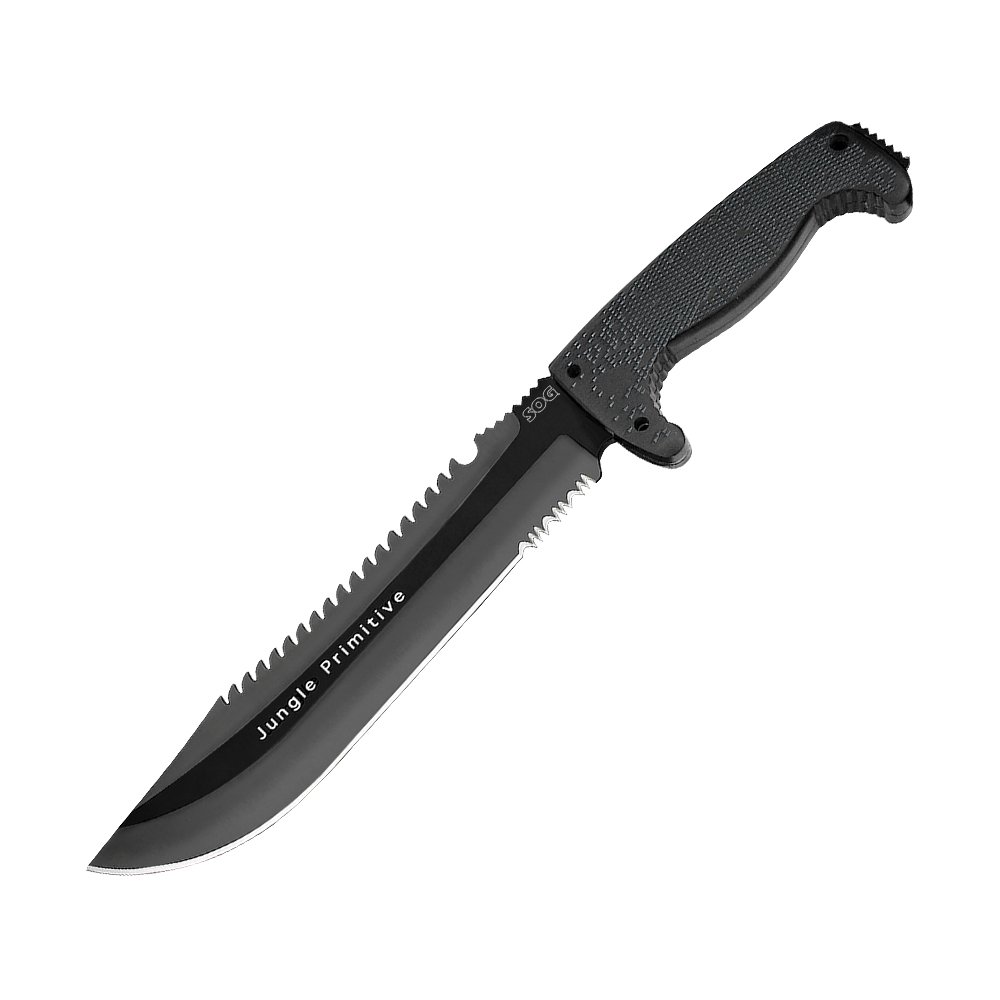

I haven't found any knife with a sawback that I like because most of the ones that I see look like this one.
I agree that a well designed one could be interesting, but for some reason I've never seen them executed well. Most of the time you see them on a tacticlol style blade made out of cheapo steel, which doesn't appeal to most of us.
The only one I know of that might be ok is the 12in Ontario Sawback Machete, but I've never heard anyone test the saw portion...

That picture you posted is the exact reason why I think most folks hate sawbacks.
Those ontario sawbacks are pretty close to what I'm thinking, but from what I've found so far, they don't have a proper offset raker tooth profile on the saw portion.

YES, the SOG 'Jungle Primitive' has a very poorly designed saw (if it were ever even intended to be functional). On the other hand, the 'SOGfari' machete actually has a decent single row cross cut saw, at 1/2 of the MSRP.
Each knife is its own animal, and should be treated as such, sawback or not.
