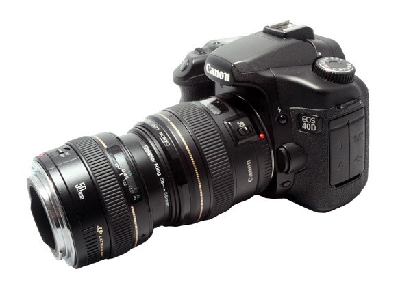

You could try: Reverse Lens Macro Photography
You need no new lens just an adapter.
