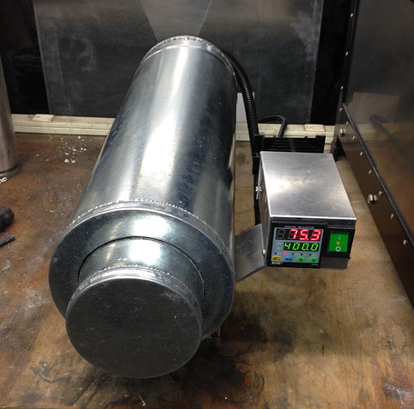

Well, my DIY heat treating oven worked out great, but of course I get a little impatient waiting for the thing to cool from 1900 degrees to 400 for tempering. Found myself shooting through the door with compressed air and figured that was probably not so good for the life of the oven!

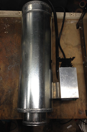

So after taking readings from my toaster oven and finding them all over the place, I decided to make a cheap DIY tempering oven that would hopefully be more accurate. Also decided that this would not be another multi-weekend project and I wouldn't spend time designing and drawing up this one. Just an early trip to Home Depot looking for whatever parts I could find then make it all up in a day. Ended up using 4" and 6" ducting pipe and end caps with insulation stuffed between. A little furnace cement to seal all up. Picked up a cheapie PID controller that came with SSR and heat sink, Thermocouple, 600w heating element from Amazon and a project box from Radio Shack.

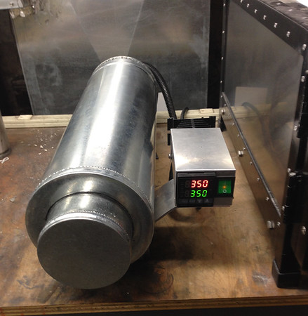

Turns out that not all PID controllers are the same, and I had nothing but frustration trying to autotune then manually tune the cheapie. Ended up pitching it and getting one from Auber Instruments the same as the one that worked so well for my HT oven, but without the ramp soak option. That tuned up nicely and is nailing temperature +/- 1 degree.
So in the end $100 in parts total- until I got the new PID for $40 more- but it works great and has lots of room for big knives- about 20" inside. Not intended to hit more than 600 degrees. Not pretty but it does the job!
Here it is with original PID:

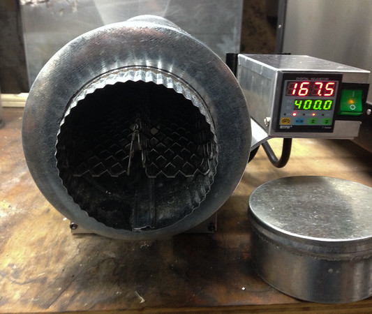

Wire mesh shelf inside:
Top View:
New PID controller swapped in:

I got this 600w element on Amazon. I have it extending from the back/bottom of the oven 12 inches into the oven. I make sure to place the blades all the way back when I load it. In hindsight, this may not be the best heating element. Since it is installed in a stainless tube there is a bit of lag time between when it gets the current and when it heats the oven, and more importantly increases in heat output after current stops flowing. Causes a bit of trouble for the PID but I was able to tune it out pretty well, and ended up telling the PID to only supply 35% power to it to avoid the extremes so you could easily get away with 300 watts or so. Good Luck!
