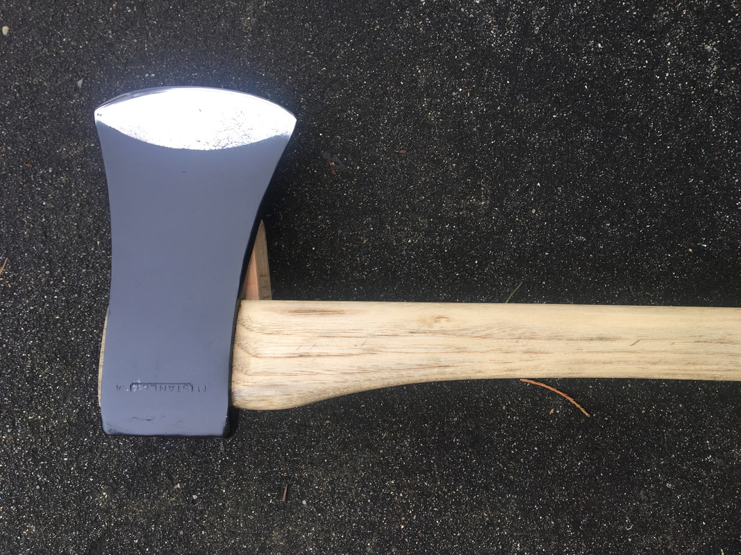

So I don’t really care for the bright white of new hickory. I’ve used old coffee grounds in the past to darken an old handle. After fitting a new/different head.
So without any research I mixed up some new coffee grounds and some vodka. Then later that night did some research and found there is an actual recipe. Coffee ground, vinegar and steel wool. So I’ve made up these two mixes. Just dumped and poured. No real measuring. I have not tried them yet. Anyone else have a DIY wood stain mix that will make new hickory look like it’s 40 years old ?

Ok so both my mixtures soaked for 24 hours. And I can say both worked the same. Not great. It did highlight the grain. But has not really darkened the wood as much as I hoped. I just slathered it on so I can’t really say how many coats. I’m guessing I have a little less than two cups total both mixtures.
I’ll keep applying it until it’s gone.
Not really worth taking photos at this point.
I may rub some charcoal into it like old axeman suggested.

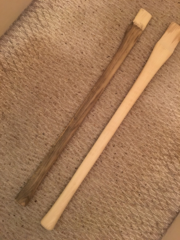

Ok So , Update!
It’s been about four hours since I applied my concoctions. Went down to apply another coat for the night.
And WOW. The handle is gray !
Well a light gray. Simalar to wreathed wood. I think I’m on to something. So I gave it a quick sand with some 220 grit paper. And applied another coat of the Coffee , vodka mixture. I’ll take a photo in the morning.
Oh and that “Smoked handle “ thing is intriguing. I’ll give that a shot sometime.
Done !
For the stain I’d recommend the Vinegar, fresh coffee grounds. And steel wool.
I made about 3/4 of a cup of the mixture using all equal parts.
Then let that mixture set for 24 hours.
I do believe the stain in the jar will continue to get darker. The longer you let it sit.
Apply it lightly. The color seams to really come through after the stain has dried.
As with all stains. You should test this on a scrap pice of identical wood.
