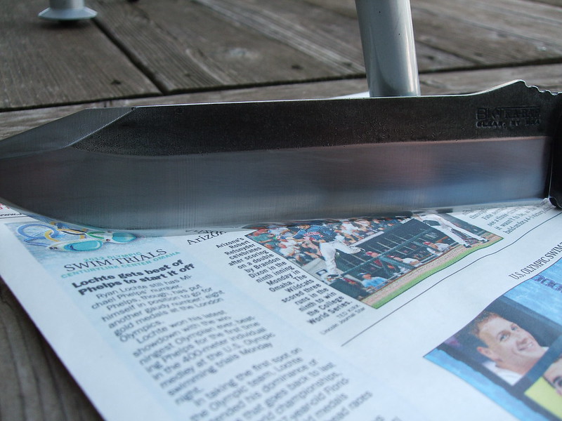

What do you guys think would be better for me, the 3-pack of 6, 3, and 1 micron DMT paste, or the 1 or 0.5 micron HandAmerican diamond spray? Do you think that one of the HA sprays could make my 9 micron edge mirror? Or should I get the DMT pastes to achieve mirror status? Is there enough in the syringes to last me a while? Right now my edges are polished, but some scratches are still visible, here is an example. You can't see too many scratches, but in the right light there are quite a few.

I use a belt sander going with the progression of 400, 600, 15 micron, 9 micron, to leather belt with Bark River CrO. This gives me a hazy mirror-like polish. Do you think that just the 1 micron spray or the 1 micron boron carbide would clear up my edge? Or should I go the DMT route? What do you like better about the BC?

I've had extremely good luck running a belt on my Kalamazoo loaded with Hand American's 1u Boron Carbide, followed by one loaded with their .5u Chromium Oxide. I'm actually planning to add a couple more belts to my selection, and pick up a ~5u CBN paste from Ken Schwartz, and probably something in the 1u range from him as well, for testing. I have NO doubt his stuff is top notch, both he and Keith are high-grade experts at their jobs, but I'd like to see how CBN differs from the other two in cutting capability. So far I haven't used any diamond stropping compounds aside from the ones for my WEPS, but that seems to be the way to go for REALLY small sizes.
