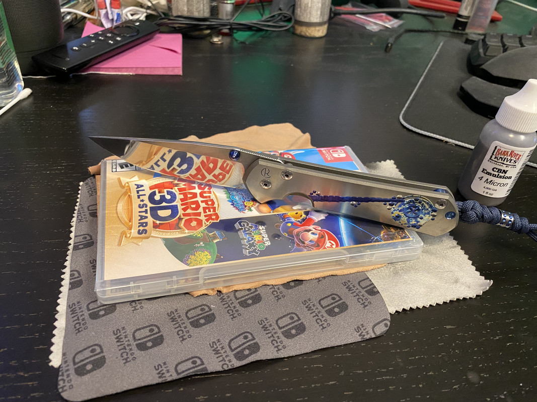

Do we really needed under 2-micron abrasives for the mirror polished edge?
Usually, at 3 microns, my edge is still cloudy. It’s technically mirror since it reflects back though but with hint of cloudiness. I usually end my lapping at 1 microns and refine the micro bevel with a 0.5 microns.
For something similar, to that thumbnail, my sebbie is around at 6 microns and was polished by hand. Not a true mirror since it has a lot of scratch still. But fairly acceptable to me. From the picture, it seems mirror but it is not really if you look in real life.

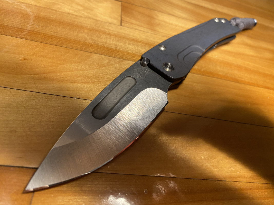

It depends on how cleanly mirrored you want your edges to be. Personally, I really don't care much for mirror polished edges. But after I bought my Wicked Edge Pro Pack III that has the WE130 clamp in it, I decided to polish the edges on my Boker Kalashnikov 74 Auto just for the fun of it. I chose it because I decided not to use it for regular use. I guess I'm now a collector...o_O
The WE Pro Pack III comes standard with Diamond Emulsion grinding down to 2 microns. As you can see in the photo it looks pretty good just looking at it with your eyes while holding it in your hands, but when you get it under magnification it doesn't look as pretty. I'm sure that going below 2 microns would look much better.
