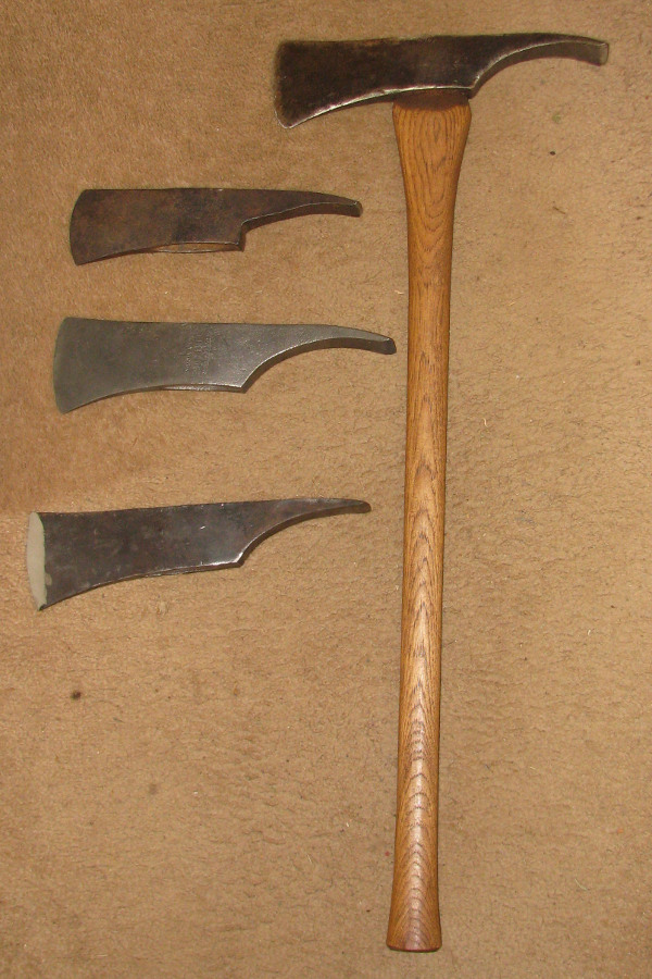

I ran into this strange sale on the bay: an antique Warren undercutter axe.
I presume someone bent the rear blade for some reason.

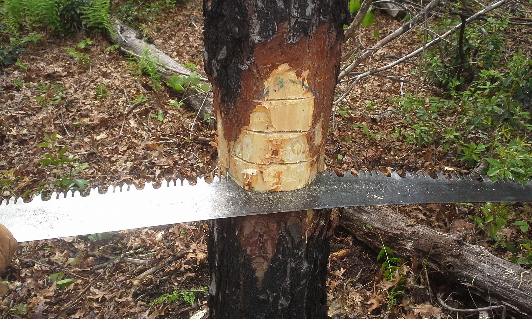

Sounds like a version of a technique I learned at at crosscut saw certification class I took last spring, only it was called a Bishop notch. Several horizontal kerfs were cut into the face at lessening distances, then chopped out. It would seem that the under bucker would break the pieces out (half rounds, third rounds, etc. Chopping them was pretty easy though. Just another old-timey technique to have in your hat when needed.
So you'd chop the half-moon rounds out by chopping them from the side, rather than swinging up from the bottom?

You'd chop the face cut down from the top, but with the kerfs cut, they pop out pretty easily. A good sharp saw cuts those kerfs pretty fast.
Thanks. Pretty interesting. Makes me want to try it with my Silky Katanaboy. Do the horizontal cuts give you any advantage over just sawing out a wedge? As Square Peg explained it, the first chainsaws could only be used for horizontal cuts, not for wedge cuts. But your hand saw can cut in any direction.
So I wonder how the undercutter axe was used. A regular axe will do what you describe. The rear blade on the undercutter axe seems like it needs to be used in either a sideways swing or an underhanded swing.
At first, I thought the underhanded swing would be perfect, because the angle of the swing would follow the face cut. Then from your photo, I thought a sideways swing would knock those sections out pretty fast, both by chopping and prying.
Undercutters were swung sideways. That bent one is most likely from abuse - using it as a pick in rocky dirt. I've bent several picks like that.
On the left it's Collins, Flint Edge, Flint Edge. The one that is hung is a Warren.

Klenman has the answer. That article is an excerpt from 'Axe Makers of North America'...
A few more details from an article about Larry McPhail's collection of axes:
McPhail also found an undercutter ax in Klenman's collection. It's one of 50 prototypes made by the Walters Ax Company for Vancouver area loggers. It was specifically designed to knock out the notch left by the first Stihl chainsaws imported to the area in 1938.
"It was a short production ax, made from 1938 to 1955," McPhail says. "I feel really lucky to have one of the original 50."

I dug up this old thread because someone recently showed a undercut axe. This was my experience with them in the 1950's & 60's. Lets start with the fact that in a logging show the fallers need to directionaly fell the trees to the best advantage for skidding or high lineing the sticks to the landing for hauling to the mill. With really large trees with a heavy lean or a lot of weight on the wrong side from where you need to lay the tree to facilitate skidding, changing the natural lay is difficult and dangerous. This is what we did (under my grandfather's supervision). Using a crosscut or chainsaw or Wright saw the technique was the same. After putting the front notch in the direction of the intended lay, start the back cut with a series of shallow horizontal kerfs like in trailtimes photo. Next use the undercutter's axe side to chop out as much waste as you could. Turn the undercutter around and use the adze side swinging horizontal to finish cleaning up the notch. This would leave you with a shallow back notch with a horizontal top and bottom. Put the saw back in this notch. Take TWO bell base screw jacks (commonly known as house jacks). Put the jacks in the notch behind the saw almost out to the bark edge. It is very important to use TWO jacks and place them on either side to form a V towards the exact direction of fall. Take up the jacks tight and then some. Start sawing to finish the back cut. Go slow and watch what is going on. Take one, or the other, or both jacks up if needed, just like you do with wedges. Word of caution--NEVER USE ONLY ONE JACK; NEVER USE HYDRAULIC JACKS.
