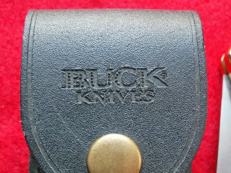

Does This 110 Look Odd???
I agree. The scales usually have a different look, and the knife is on top of the most faked Buck box.
Another give-away is the length of the box. Every 110 I've taken out of the box has had a sheath that hadn't been "folded" yet. In other words, the box is long another for the sheath to go in with the flap straight and flat.
The pins all look the same size and look like brass--unless my eyes are deceiving me.

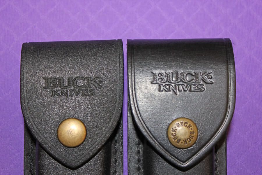

And the snap on the sheath is plain, I think.
Seems to me this just might be the first of a bunch of pretty darn realistic 110 fakes.
This would fool most people (would not fool the guys on this forum, but normal people would probably fall for it).
Whoever's making them wouldn't just make one or two.....there will probably be a flood coming if it isn't already out there.

I haven't seen any NEW sheaths with a plain stamp......I have seen the old Atchisons with the plain stamp.

It appears to be the same sheath as this one and I know for a fact that it's a fake (as is the 110).
It's especially obvious when you compare a real one to the fake. There's also a lot of difference in the feel and look of the leather in hand. The fake feels a bit like cardboard.
