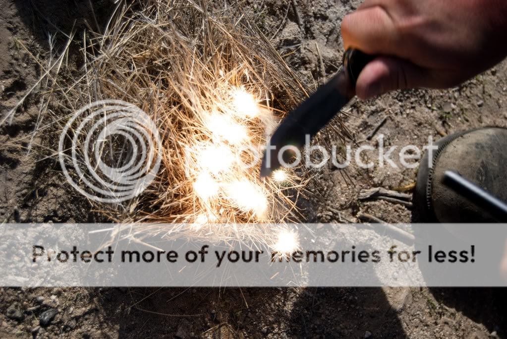

I have had better luck with a squared spine. Below is a picture of my Charles May 'lil friend scandi 1/8" spine, S30V stainless steel.
