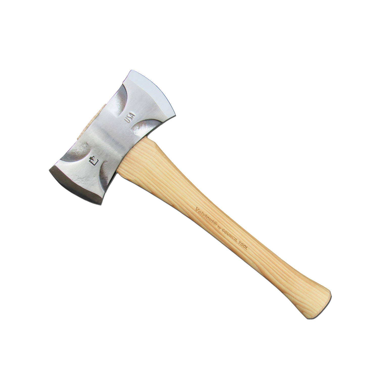

Council Tool
The top-of-range Velvicut line doesn't include a full size double bit axe. They do have an amusing looking 18" double bit"saddle axe". For all around camping utility I am pretty happy with my Estwing hatchet, for about 1/4 the price. (Plus, good for pounding tent stakes.) But the little double bit is cool looking:
It should be. It's $147.
Moving down range a bit they do have a few nice looking models in the Michigan Railsplitter line, which seems to come in three variations. The least expensive ($62) has a rough cast and black painted blade paired with a fiberglass handle, the middle version looks like the same head, red paint and a wooden handle, and the top has a nicer finished and polished head with a wodden shaft. It's priced at a very reasonable $87 It's described as: 3.5# Classic Michigan Double Bit36″ Straight Wooden Handle and is pictured below:
The prices on these I've listed are from Council Tools web site, these are widely available and may be priced a lot less at retail or form web sellers.
