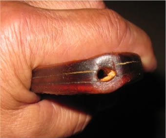

I punch a hole offside then put a eyelet in the hole to line it.
You've piqued my curiosity, but I can't picture it. Got a pic?

appreciate the summary of pros and cons, also. i didn't realize some of the sheaths i was viewing had only been drilled on one side, i guess i assumed it was str8 through. the off side makes alot of sense, but i still just can't get used to ANY of the blade being visible while the knife is sheathed. i might end up trying it, though, seems easier than what i do - i have a small wooden dowl that is slotted on one end, that end slides over the tip of the knife prior to molding and extends through the bottom of the sheath.
