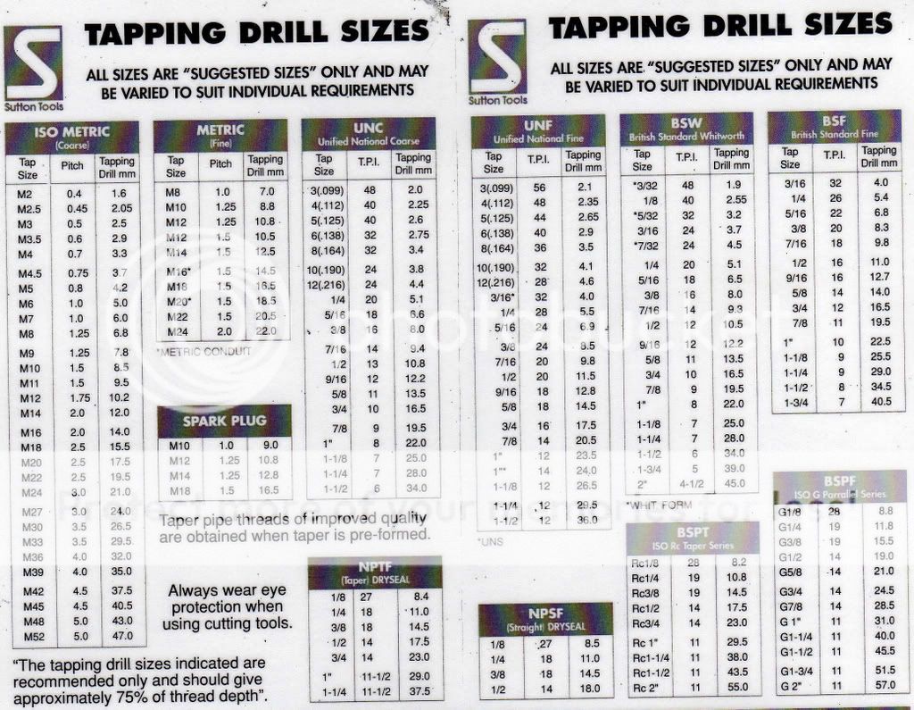

I was given some 1 1/2" square bar and decided to make some arms for my KMG with it. I want to start by making a bar for the "small wheel adapter". Now, here are the stupid questions. Is there a chart that shows the correct size of hole to drill for each bolt size? Such as if I want to thread a hole for a 1/2" bolt, what size hole would I drill? If I drilled it 1/2" and then thread, wouldn't it be bigger than 1/2" once threaded? Next question, I have the "small wheel adabter" with the holes already in it, how do I find the EXACT center of these holes so I can match them up on the bar steel? So that they will bolt together without "slop".:confused:
Charles to tap a 1/2"-13 Uss thread you would use a 27/64" drill bit. Also you can look on your taps and they will usually list drill size on them.

To find the minor diameter of a thread (your drill size) subtract the thread pitch from the thread diameter. It is that simple.
For example a 1/2 13 thread:
The thread pitch is 13 TPI, or 1/13 with is .077 (distance between threads)
So your ideal drill size is .500-.077 is .423
The thread pitch subtracted from the thread diameter will get you about a 75% thread engagement, which is a very good amount. Simply select the closest drill to the calculated diameter, for example the drill mentioned above 27/64 is .422.
Folks, reread this and memorize that simple fact, it will serve you well. You'll never need another tap chart.
Thanks to everyone for the replys. I found a tap chart but thanks to Nathan it looks like I won't be needing it.

Hi,I just uploaded this chart to my Photobucket account .
