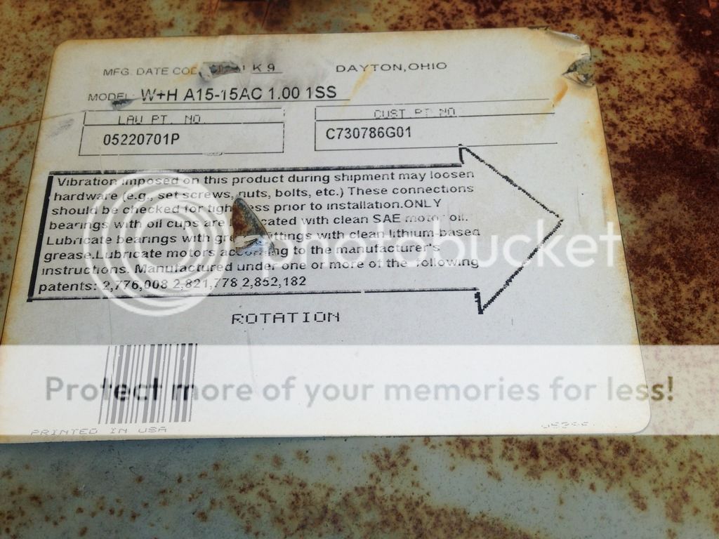

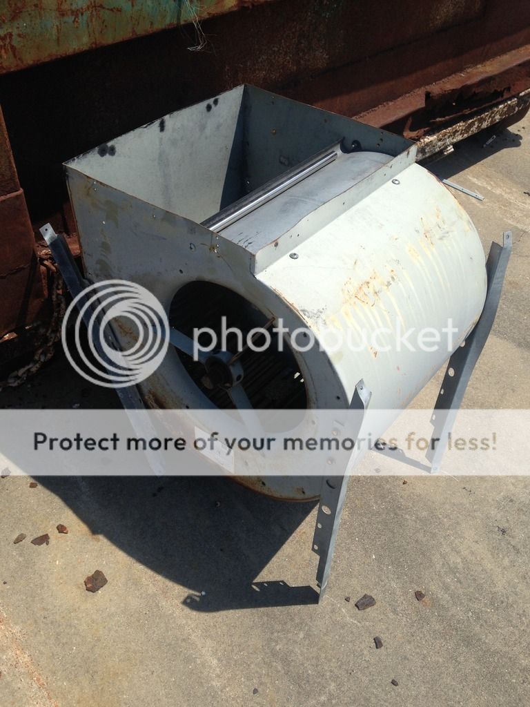

Hi all. So I was just out taking in my afternoon smoke break and decided to check out the scrap dumpster at work and low and behold a squirrel cage fan is up in it. Talked to my bud the maintenance manager and inquired if anything was wrong with it. He said nothing other than he was tired of looking at it and being in his way all the time and if I wanted it to go ahead and get it, as he knows I like to build stuff.
Anyway I believe from the number on it it is capable of 3000 CFM

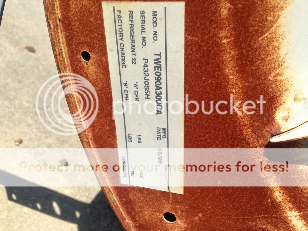

I looks like it's from a train twe090a300ca 7 1/2 - 20 ton unit.
Do you think this is way to big for a collection system?
Part #: A15-15AC 1.0 1SS

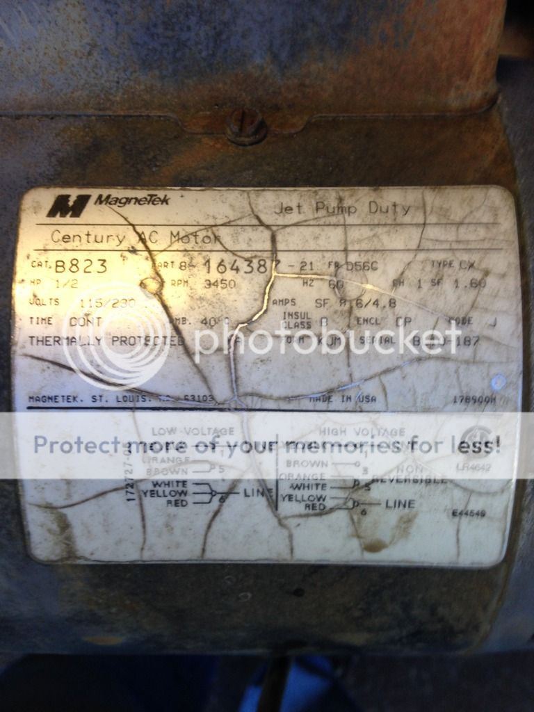

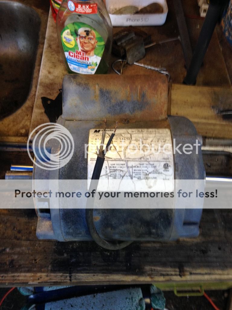

Well it's a good day in Pleasanthill. Just got a 115/230v 1/2hp motor for free as well. It's a jet pump duty motor but I think it'll suffice. It was free anyway. And has a standard 5/8" Keyes shaft.

I am sorry to be the bearer of bad news but you will never get the velocity with that blower. I have spent countless hours with this rig.... consulted professional HVAC and industrial filtration technicians.... your system is limited, brother. Functional... but limited.
Rick's right, it's not the right type of fan. The squirrel cage fan is designed to move air efficiently, but not against much back pressure. It's designed for very large ducts with fairly low airspeeds. It takes 5000 feet per minute airflow to keep steel and abrasive dust moving reliably in a duct. At 3000 CFM the closest size would be 10" diameter. But if you hook up a cyclone or filter, or both to your fan you will have put enough back pressure on the fan that it won't be moving 3000 CFM anymore. Even just reducing the intake on the fan to 10" will cut the airflow dramatically. If you reduce the duct size to increase velocity you put more back pressure of the fan and airflow will drop even more. It's a vicious cycle you won't win. You need a fan designed for the purpose, radial fin, airfoil, caged impeller, etc.

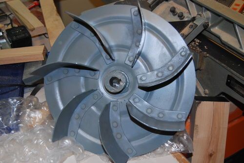

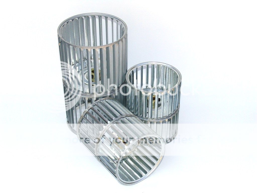

I'm going to post these images so anyone that happens across this thread can see the difference in fan blades.
This is what I have that won't work.
This is the type in a typical dust collector that would work.
What it would do is make a heck of a fan for ventilation, just moving air into and out of your shop.
