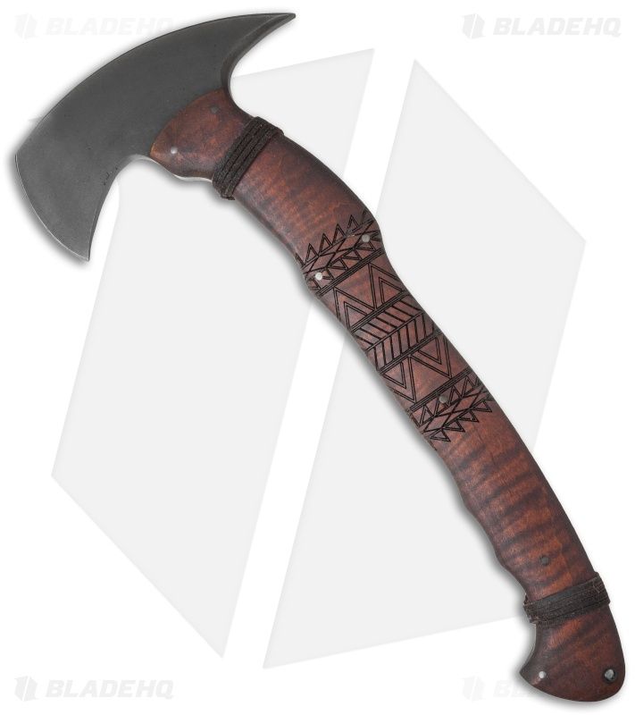

I'm wanting to dye some curly maple scales to match the color of the scales in the picture of this Winkler axe (photo by bladehq). I have a beltknife II, and I'm wanting my axe to match it. I'll be making them from scratch (first time). I've also never worked with wood before, or shaped any scales.
I've tried searching , but, I can't find info on how to make it as dark as the ones in the picture. I've read that maple can be difficult to dye compared to other woods. Some dark dye turns it pink?
Can someone point me in the right direction please?

Behlen was what I first started looking at. I just couldn't find the contrast with the maple that I want. That black/red color. The blood red does look the closest to the color I want though... is there a way to make the curly pop more with this stain?
Will the fieblings dye colors show up like the samples? Looks like mohagany is the closest in this dye. I've read on some past threads that some people have done Black , sanded, and then a dark red on top. Should I consider that or no? Thank you for the help guys.
I've also been reading up a lot about Aqua fortis, it just doesn't seem to be that rich deep red I'm looking for. Could I add like a fiebings dye or Brieling stain on top of that?
The fieblings light brown has a slight red tinge, and I've mixed mahogany or oxblood with it to get a rich Koa like colour. The amber analine dye from Lee valley is fairly red too.

Is the stain you have the color you want? Using the knock back technique, you can repeat it until the desired figure pop you want is achieved, but still have the color you like. Other than that, you have to add darker dyes to the undercoat, and that changes the dynamics of how the color shape play when overlapped. I'd test on scrap. That said, I can usually get extremely 3D figure in big leaf and European flame maples on guitars repeating the application and sand back method. When someone wants truly darkened flame with a color over it, I use much darker colored dye to wash the grain with, sand back, and then put the lighter pigmented finish coats over that. If you want blackened flame with blood red, you'll have to do a darker treatment to darken the flame first.
This for example is high contrast doing black dye first, sanding back, and then applying color coats.
Coloring wood is a challenging business and the desired results are often elusive. Getting the right color is a trial and error process that often requires 3 or 4 colors (dyes or stains) to work from and multiple samples. I've done as may as 20+ samples trying to achieve perfect matches. Fortunately you don't need a "perfect" match. The secret to success is to make certain that your samples are of the same material AND just as sanded and clean as to the same level as your intended finish piece. If you don't properly prep your samples you will never know the final results until you do the final piece.
Dyes can look incredibly different when first applied - browns can be very yellow for example - and you can't know the end color until you process all the way through to your final coat of finish. Stains are more revealing of the potential color. As ERRN writes above you can knock back to dark a stain by waiting at least overnight then sanding to lighter or by wiping with mineral spirits when the stain is still wet. You can also establish some control and some grain highlighting (pop) by applying a coat of thinned Boiled Linseed Oil or WATCO oil. This seals the more porous grain so that the stain doesn't over darken. Mixing stains of the same brand is an option too but be sure to mix enough to complete the job. Nearly impossible to mix spoonfuls and then duplicate the final effect.
Bottom line is to be patient with the process - prep work, drying times between coats, sanding and cleaning between coats. Don't sand stain unless you are trying to change the color - sand before stain and after between coats of finish. AND don't beat yourself seeking perfection in the color. Get close and be happy. Why beat yourself up. Good luck.

I'm literally torn between AquaFortis, Behlen stain, and Fiebings dye. Does maple wood work better with one or the other? And what do you find works easier/best for you? I like the knock back option and I feel like stain is easier and more forgiving?
But, just google image searching, that AquaFortis looks damn good in some pictures, and as I understand it, It will darken with time. But, I'm worried I can't get it dark enough. I've read that it will stop reacting after about 3 coats.
I vote for the feibings leather dye. Especially not having a lot of woodworking experience. Wear gloves or it will look like your fingers tore through the tp.
I don't like wood stain with figured wood. Tends to finish blotchy.
With dye I would go a shade or two darker than you want. Then lightly sand with 600 grit till you like the shade.
Finally a clear top coat.
Looks like I'll be going with Fiebings then. What clear cost do you recommend? I want it finished in as matte as possible. I also ordered a bottle of Aquafortis as well
